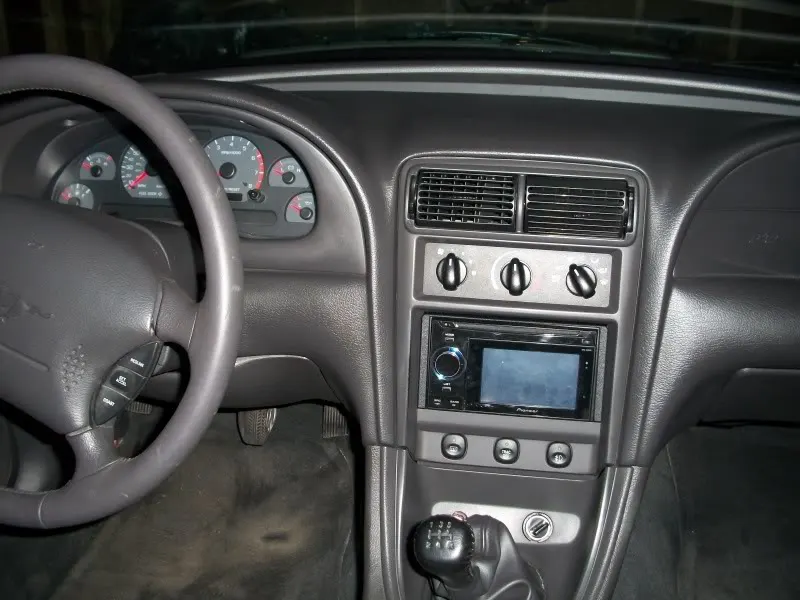

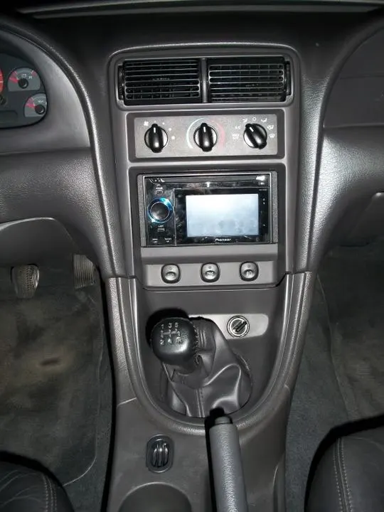

I just purchased a Pioneer Double din Unit that i will link below. It was very cheap in my mind for what i got.
Touch screen GPS unit.
Detach Face
Blue tooth that synks with phone works great use it every day
Ipod input with cable ( you can get the cable at best buy)
Has Aux input for Head phone jack (this is how i run my wireless XM)
I use my USB for a flash drive with Mp3's but you would use it for your ipod input which is then controled by the HU everyone online liked the link.
http://cgi.ebay.com/PIONEER-AVIC-U3...tem&pt=LH_DefaultDomain_0&hash=item3eff5629d7
I bypassed the harness so i can use it while in motion, I have owned many aftermarket decks and this is by far my favorite. I did install a whole stereo system with a 4 channel amp and new speakers all the way around with 3 10" subs. So i cant tell you the mach system will sound perfect, but from what I have read no mach system sounds great with aftermarket head units.
That bieng said swaping out the system in the car is the easiest car radio install i have ever done.

Damn, that Pioneer double din is badass looking. It doesn't play DVDs though, does it? If I can't find a decent one that will play DVDs, then I'll go with that one. How much did you pay for it? Also, is that a USB port on the front?
