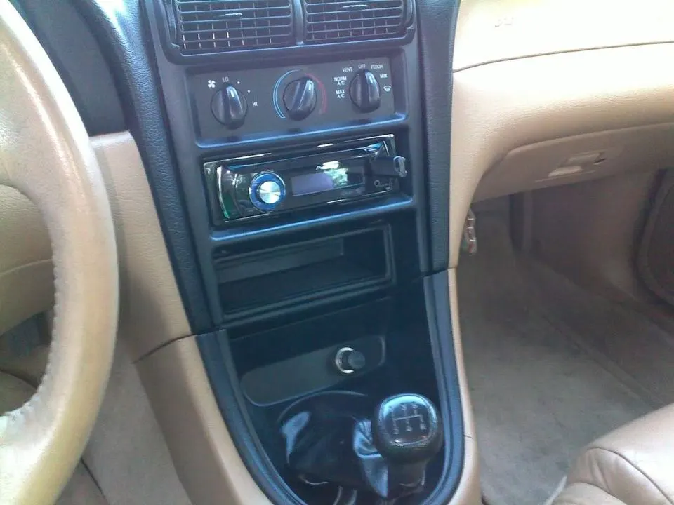

This is what's in my car:

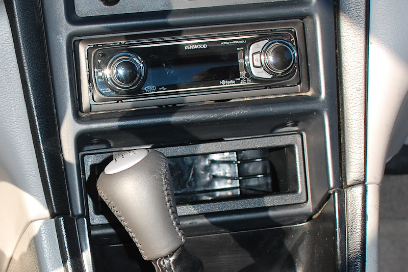

Giving this thread the Christmas bump too: Found a Kenwood KDC-MP642U under the tree :D
So far so good. I really like the iPod controls - easy to browse through by playlists, artist, albums, etc., and you can even search. It also remembers exactly where it was if you take the iPod out, go do some other stuff with it and then come back - just picks right back up wherever in the song it was playing and keeps track of the song order if it's on shuffle -I was hoping it would do that and it does.
Overall, the UI isn't bad but still not as direct and intuitive as I'd like but, it seems to suck less than the interfaces on other aftermarket stereos. I'm going to have to actually read the manual for how to program my radio stations in :nonono:
It's too early to give it an honest review yet, but I think I'm really going to like it.
A couple of observations: First of all, installation was indeed super easy! Crutchfield included the radio harness adapter, RCA preamp out to factory amp harness adapter, radio removal tool, DIN storage tray to take the place of the CD player and the support bracket it needed. Only had to solder 5 wires on the harness adapter and then it took, literally, 5 minutes to remove the factory pieces and install the new stuff.
Second, Ford must have packed a good bit of DSP into the 460 head unit because the Kenwood sounded totally flat and lifeless before I started digging in the parametric EQ and other processing options. I always ran the tone controls flat on the 460 and bumped the bass up one notch for some sources and it always sounded big and full. I know it's cooler to bash factory stuff but Ford and whoever they partnered with on the Mach460 really did a good job with it - really well designed system for a factory setup.
Here it is installed:
I don't like the storage tray that came with it that much - I don't need the CD slots taking up space and I'd like a more OEM looking one that is lined with the thin carpet-like stuff.
I haven't done anything with the USB cable yet, it's just coming out the back of the console on the passenger side right now. I ordered a retractable iPod cable so I may see if I can rig that up in the console to keep things tidy.
Again, thanks for everyones' input :cheers:
Looking for single DIN cover
Glad to hear about your recent find. I wish stuff like that would appear under my tree.
About that CD storage tray. Any ideas where I could get one for myself? I have a 2000 GT with the separate CD player. When the CD player crapped out, I installed a single DIN combined head unit. I now have a hole in the center console where the CD player used to be.
At the time, I thought it would be no big deal to just "buy" an off the shelf single DIN blanking panel. I found plenty of examples for sale from the UK. No cost effective options from the states.
Someone also suggested getting the blanking panel out of a salvage V6. I learned two things. 1st, most V6's came with CD players. Next, the salvage yards will not sell pieces from a good center console. Must buy the whole console.
If my memory serves me, Ford wanted $65 for the V6 cover. The hole doesn't bother me that much.
Woah! $65 for a blank panel! It's really weird what parts ends up being ridiculous at the dealer and what ends up being reasonable.
2000s still have the 2 separate single DIN slots for the head unit and a CD player, not a single double-DIN hole, right? You can get a tray and the hanger bracket from Crutchfield, this one from LMR that StangGT97 mentioned upthread or any of the other online automobile A/V suppliers but it's tricky finding them on their sites because there's no agreed upon name for them - pocket, shelf, tray... and they tend to not show up when browsing through different categories where you might expect to find them.
Your local Best Buy may have some in the back in their install shop and a local car audio store would probably have them too.
Does anyone know where I can find one that has the carpet/felt lining like OEM trays have? I'm having trouble finding one of those.
