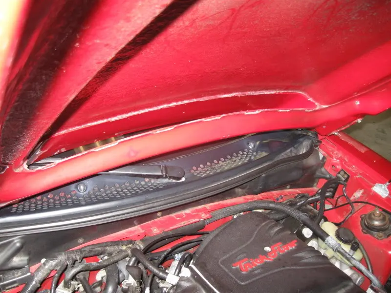

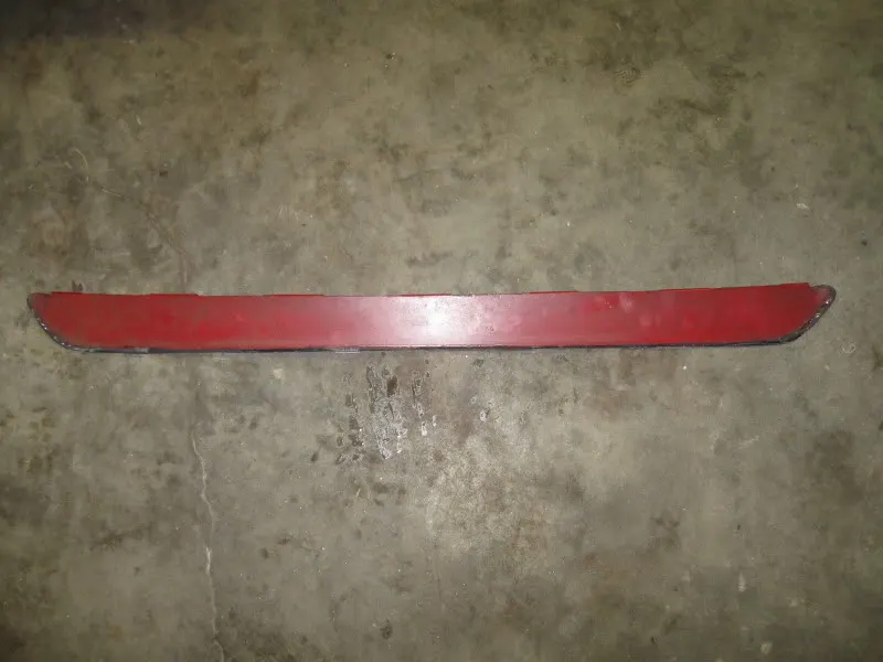

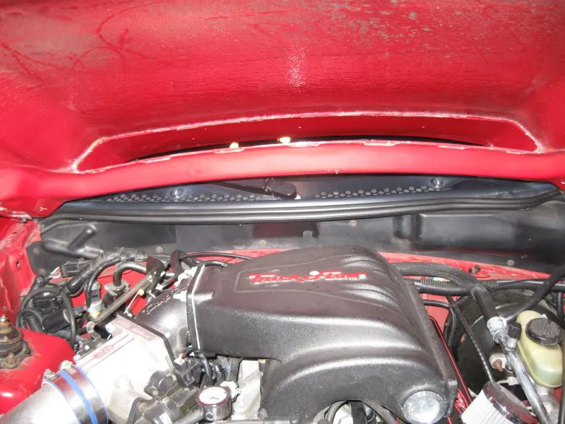

I recently took off my Cobra RR hood and removed the back insert that was on the hood that kept the heat blocked in. It was held in w/ rivets and silicone. What I was wondering is does this in anyway effect the structural integrity of the hood? The reason I'm asking b/c I'm not sure if its just in my head or not but its almost like I can see the hood "flex" while driving. Of coarse the thought of some air pocket now being formed under the hood and causing it to fly up and smash my wind shield crossed my mind.
Yes its dusty and needs to be washed. Its on the agenda friday.
I honestly could not tell you the answer to this. I can see it having some role in holding everything together, but not in the right areas.
What you are seeing is simply cowl shake now that the air is able to flow in that way, but...so long as your hood latch is in strong condition, and the hood is reinforced in the latch area, you shouldn't have any problems.
Do you run hood pins?

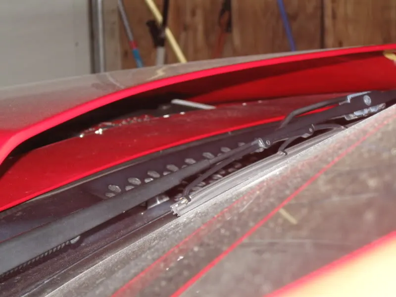

no hood pins and the hood latch is pretty strong. I pulled up on the hood one day as hard as I dared to and no sign of it wanting to come up at all but I was not sure how it would react while driving. It may have always had that shake or flex to it and I never noticed it. Just want to be sure I didnt do a big no no. I was going to drill holes in the panel that I took out but I could not get a hole saw to fit in there b/c of the angle so I said screw it and took the whole thing off. I will admit its pretty cool to be doing down the road and drop some weight on the gas pedal and be able to see the intake torque to the side :nice:

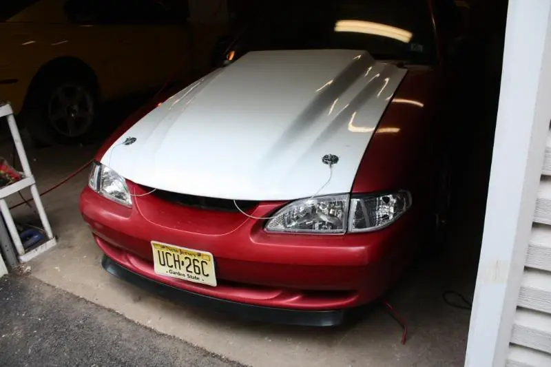

Get some pins on that hood and dont ever worry about it. Without them there is always a chance of it coming up period the end. I dont care who makes the hood or how strong you may think its latched. No need to even take that chance unless you are looking to buy a new hood and paint job one day.

I did the same thing a few years back...Yours looks like it has an insert in there...that should be the stiffener right there. Mines an H.O.Fiber and yours looks more rugged in that area.
Mine flutters some...paint shows no signs of cracking so it cant be moving all that much... Lotta heat pumps outta there... in the Fall it fogs the window.
I had seen a pic a while back were a guy had mounted 1 hood pin on the underside of his hood, so that there was nothing protruding through the hood. I don't care for the look of hood pins so I think I am going to attempt to do something similar when I do my pins.
