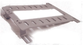

Holcomb makes bracket that adapt those seats to Mustangs.
Go here to see. Search for seats and Related Parts.
http://www.parts123.com/PartFrame.a...holcomania.com&TITLE=Holcomb_Motorsport_Parts
