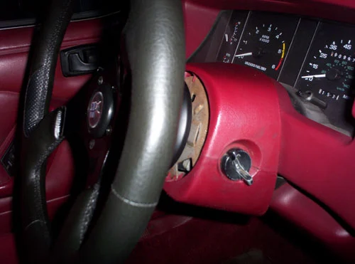

I put an aftermarket steering wheel on my 93 convertible. Problem is that they dont list a kit for this year because of the air bag so I used a kit for an 85-89. it works and everything but there is a gap of like an inch between the plastic trim on the column and the metal cover on the adaptor hub. Anybody ever put an aftermarket wheel on a 90-93? What did you do to make it look right?

The kit came w/ 2 sizes of trim ring. I put the larger one on. Nevermind the dirtiness of my car, I hadn't got it cleaned up yet from the paint job and putting it back together.

That looks not bad at all. Maybe cut out some 5/8th plexi, round off th edge, paint it black, and figure out a way to stick it behind the wheel. If there are threaded holes you could even screw it in. Thanks for the pics!
