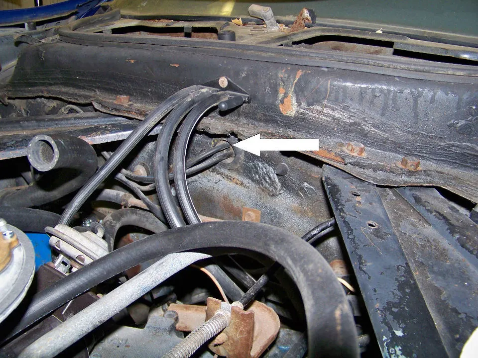

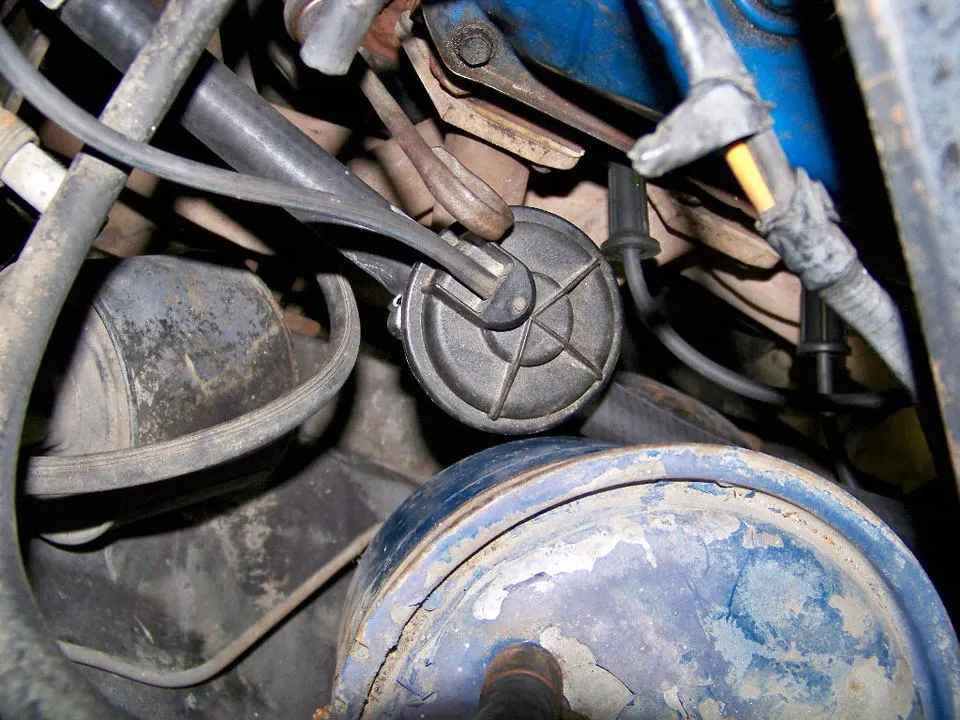

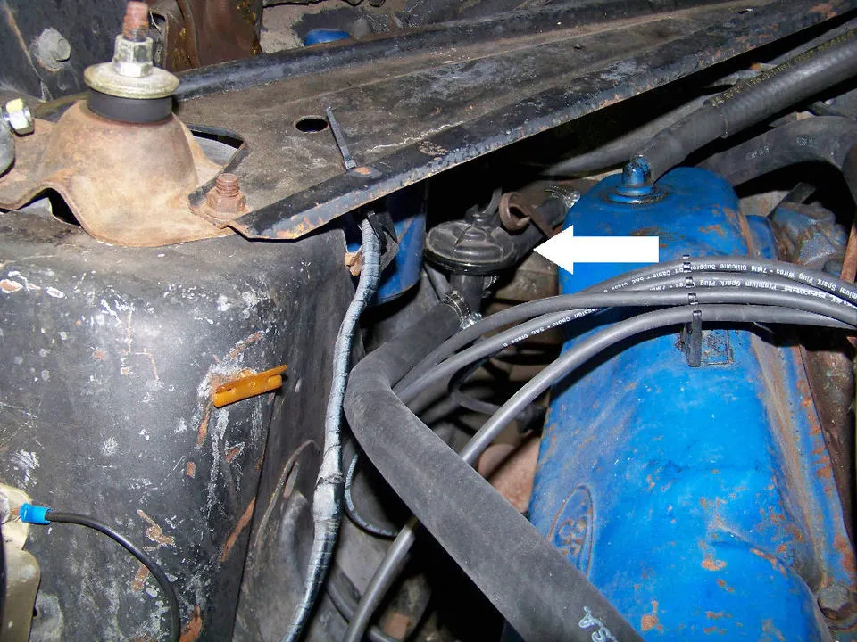

Here's what mine looks like:
Here's where the vacuum hose exits the firewall to the heater control valve:
