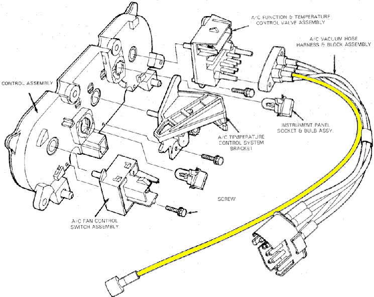

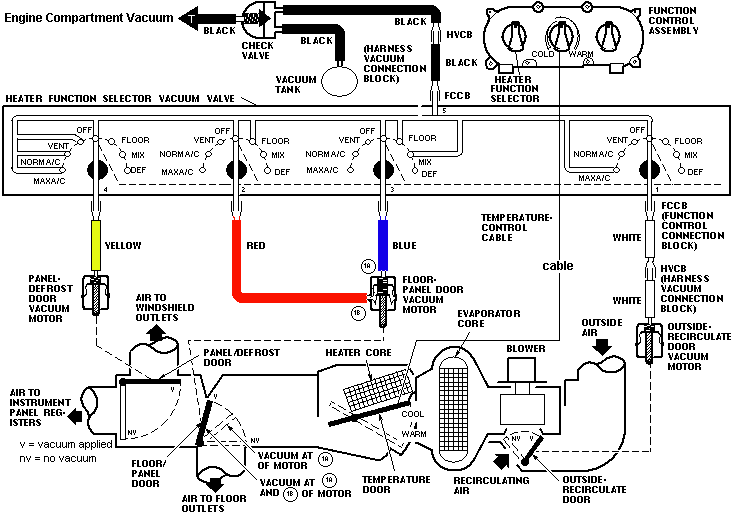

You may have lost your vacuum controls - check vacuum lines
