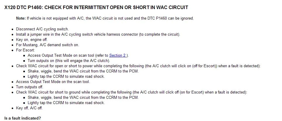

BTW, do you have a P1460 set?
The attachment is from a Ford service manual. It wouldn't let me print to a pdf, so I had to do a screenshot. If you have a WAC circuit fault, this is tell you.
