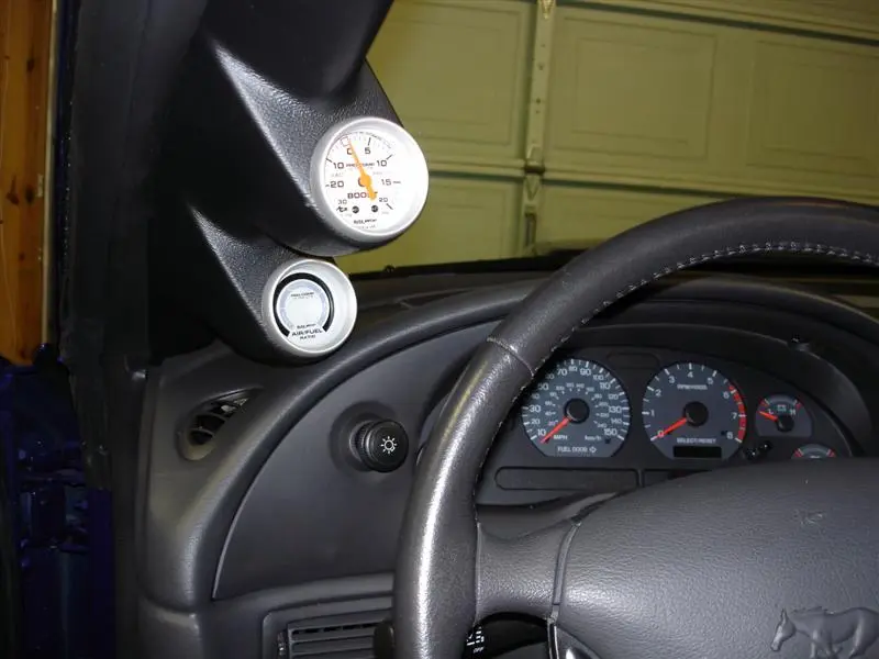

Here are mine, installed today:
fuel pressure guage is a must if you SC. much more important than a narrow band AF guage. Do you have one?
Actually I decided against the Fuel Pressure gauge. Wideband A/F is better than FP and that is why I did what I did. I will have the wideband controller soon enough.
