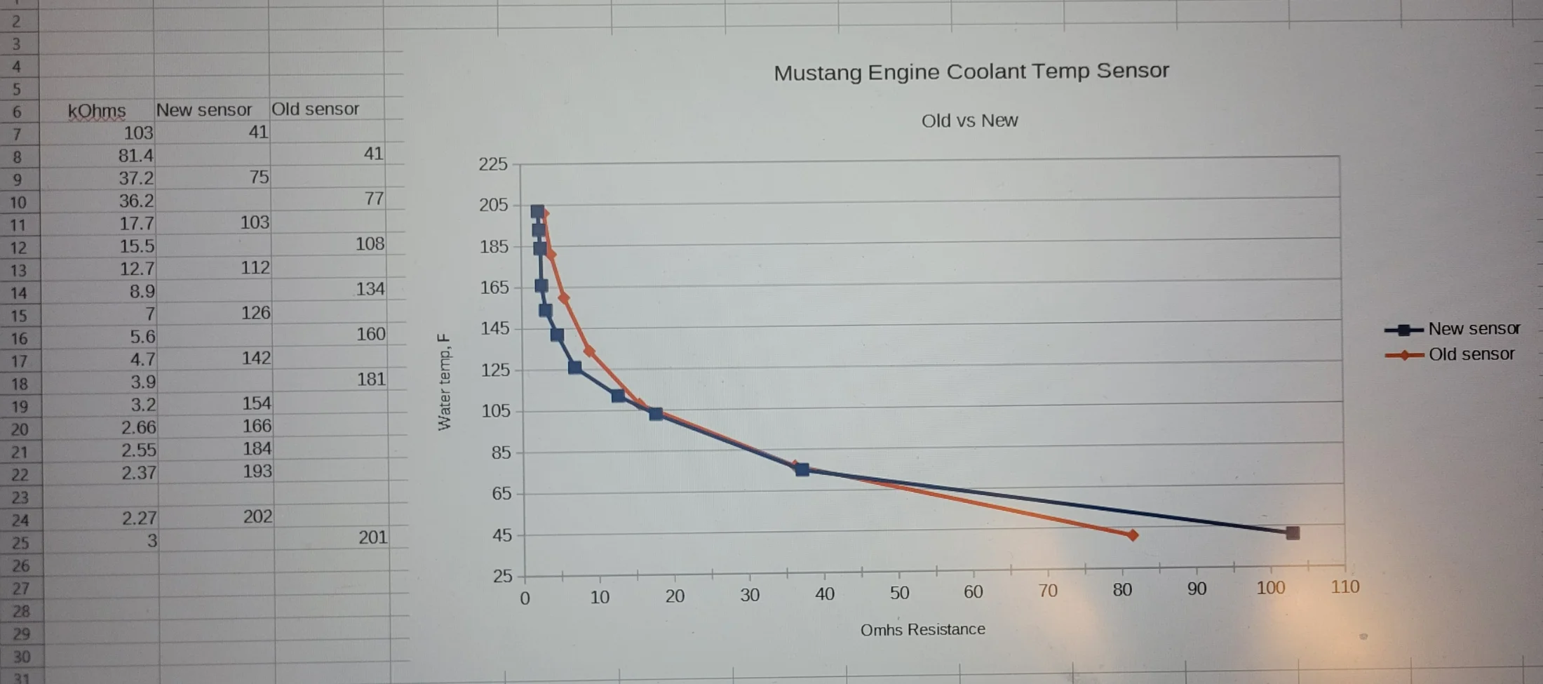

Move to code 21: engine coolant temp sensor out of range. Replaced coolant sensor and checked ohm resistance for old and new sensors, seems close to chart someone published previously (see image attached). Engine cooling fan switches on after extended idle. Checked continuity of wire from connector to pin #7. Will check voltages at sensor today. Clearly the ECU recognizes sensor voltage change to switch on coolant fan. Have WBO2 to install to check whether O2 sensor is switching to closed loop, waiting on AEM to replace my faulty display.

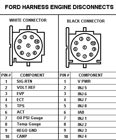

No, there are two eight pin. but otherwise the sensors are direct wired into the harness to the ECM. I think if you had a 'connector issue' it would be higher resistance due to corrosion or a open circuit. I've already checked continuity from the sensors/solenoid directly to the 60 pin ecu connector. Maybe I will back probe with key on to check voltages received at the ECU. Thanks
Reactions: General karthief
10 pin salt & pepper shakers are for the 5.0's. Seems like you've done some exhaustive testing on the components. In my limited experience, after component testing, the two main areas that are left are the wiring harness and ECU. Granted, you've tried 2 ECU's. Keep in mind they're both 30+ years old and one of the main complaints about them is, as they age the capacitors tend to leak causing all kinds of issues. You seem electrically competent so you may want to try pulling the case off and examining the board for obvious leakage, etc. The ECU Exchange will rebuild it for a reasonable price.
