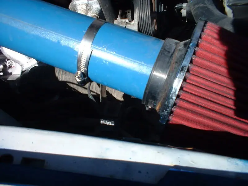

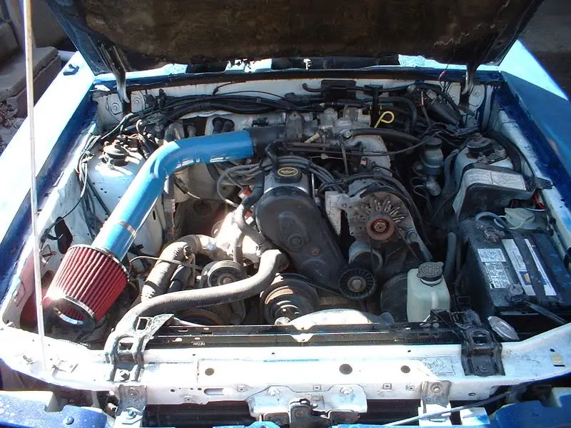

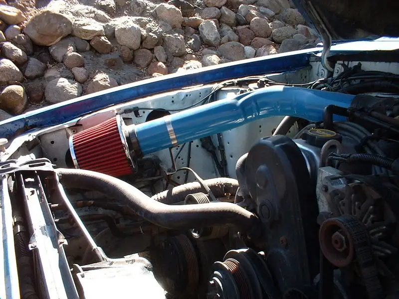

i went to autozone and got a 3in diameter peice of exhaust pipe. i think it was 16 or 18 inches long, it needs to be trimmed a couple of inches. One end of it is flared, that part goes into the elbow that connects to the throttlebody...just tighten down the clamp until the pipe cant be pulled out of the elbow and youll be good...ill take some pics tomorrow of it

<a href="http://photobucket.com" target="_blank"><img src="http://i101.photobucket.com/albums/m64/fastmonkeywheels/DSCN1505.jpg" border="0" alt="Photo Sharing and Video Hosting at Photobucket"></a>
<a href="http://photobucket.com" target="_blank"><img src="http://i101.photobucket.com/albums/m64/fastmonkeywheels/DSCN1502.jpg" border="0" alt="Photo Sharing and Video Hosting at Photobucket"></a>

That one is perfect. So the flared end of the pipe goes in the top rubber elbow then? Looks good (as do the rest), it's paintable, no cutting is involved, and the silencer can be slid right back in! I'll have to remeber to clean the pipe real good before installation. How restrictive are the silencers? Has anyone noticed a difference after removal?
Yep the flared end goes into the top rubber elbow. I noticed a little bit of a difference, mainly a little more torque, and it was in fact louder w/o the silencer, but ive gotten used to it now, so maybe its time for a ranger header
