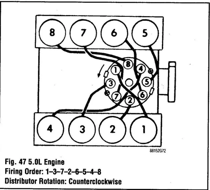

recheck all your wires with the diagram below.if all wires are correct ..remove #1 cylinder plug and place your finger over the sparkplug hole and seal hole with your finger. then turn engine by hand until the pressure blows your finger off the hole. insert a screwdriver carefully into the sparkplug hole til it touches the top of the piston and continue turning engine carefully until the piston reaches the top which you will see using the screwdriver. at this point you will be at top dead center remove dist. if necessary but ensure the rotor button is pointing at the #1 plug wire on the cap and you have equal amount of movement twisting dist. to right and left. install cap and attempt to start you may have to twist dist. but it should start.

Nice post by Bill. You sound like your dizzy stab was a little off and you might be 180 out.
Good luck.
JF, he can still get a base [cranking] time on it. It's enough to see if one is even in the ballpark. The hope is that once in said ballpark, the car runs well enough to set the hot-idle timing.
