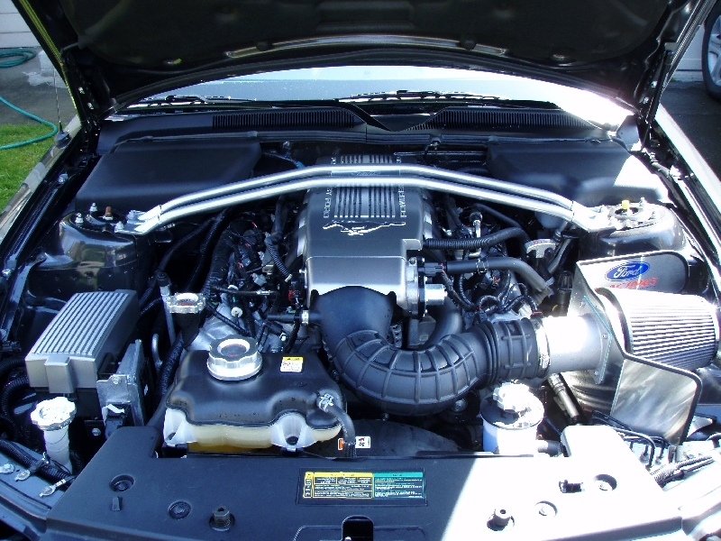

I have the oem Bullitt brace which is the same brace as the FRPP V6 brace,
clears the oem manifold cover with room to spare, no need to shim.
