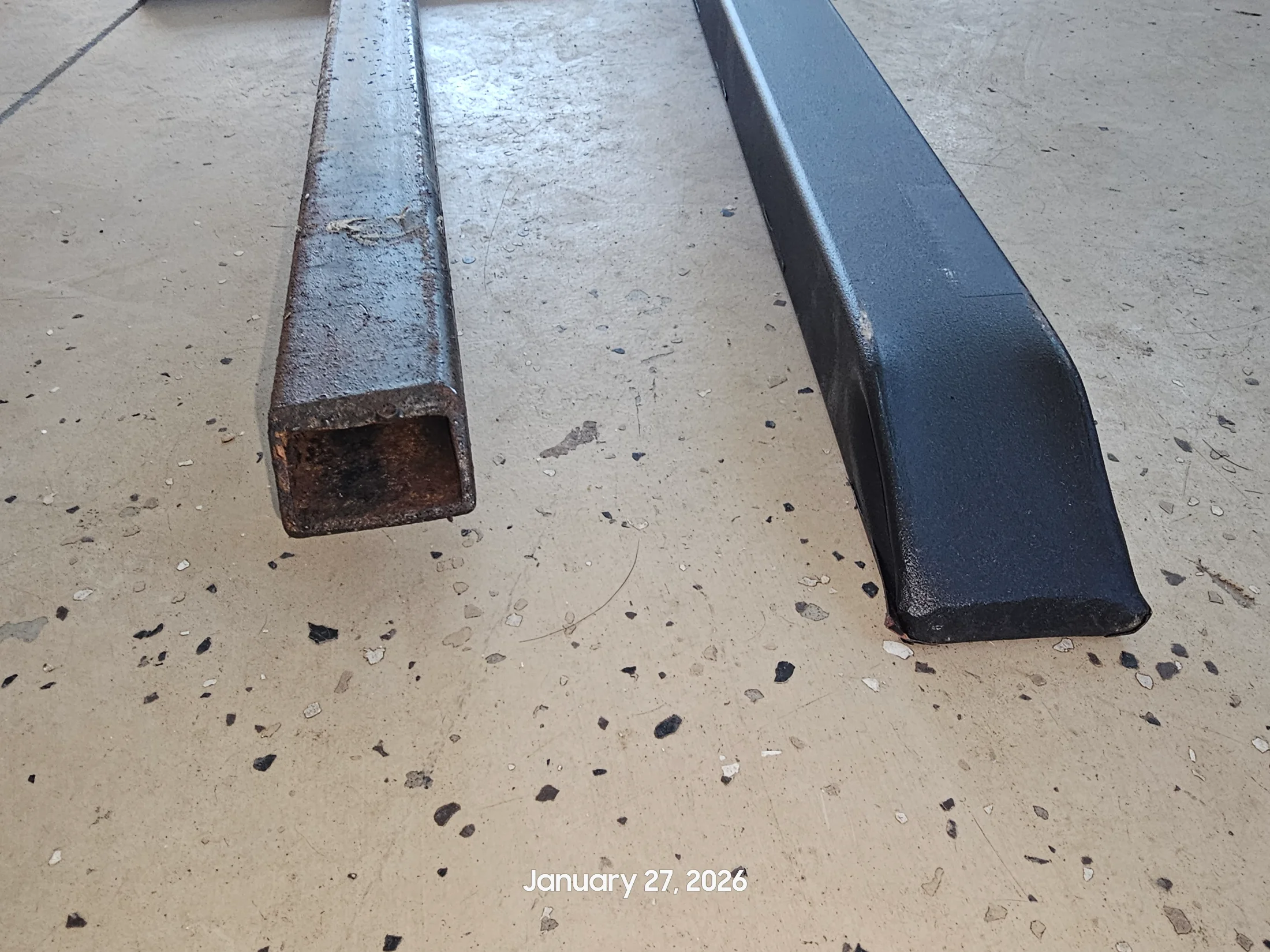

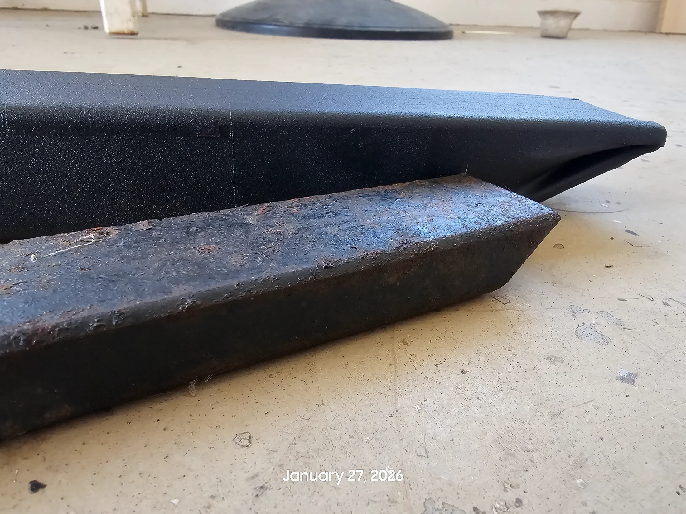

I bought some cheap subframe connectors a few years ago, though I don't remember if they were SVE or some other variant. I never had them installed as the project was on the back burner for forever. I recently bought a set of Stiffler's because I really think I want to go with their FIT web braces for my vert. I just went out to the garage and took a couple side by sides for you. The "other" brand is smaller in every dimension except maybe wall thickness, I didn't measure to know. But the Stiffler's are also pre-bent to follow the floor pans more closely whereas the "other" brand is just a flat tube the full length. There is definitely more "beef" to the Stiffler's product than there is to the "other" brand. I'm gifting the "other" brand to my brother for his T-top car - they've got to be better than not having them at all - but I'd bet that the Stiffler's product would work better for heavier duty use.

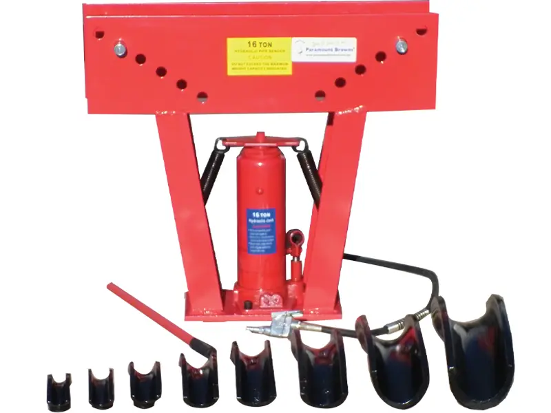

25 years ago my brother bought a bender like this - I don't remember what tonnage it is. I use the die that the rectangle tube just fits within the vertical sides. I set the two other rollers close to the middle if I recall. I am not putting a huge bend on the rectangle tubing (17 degrees total if I remember the Mathis book numbers off the top of my head) so other than the bend it doesn't deform my subframe connector - or at least it didn't 10 years ago when I bent the ones for my car.
