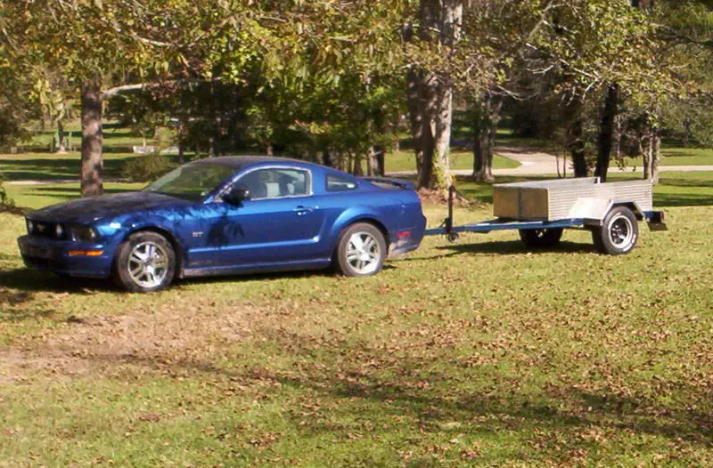

If I could post pics here I would. Started with a Jet Ski trailer, stripped it down to the basic frame, painted the frame a dark metal flake blue (closest thing to the car's Vista blue) Then mounted a 42" wide x 72" long x 16" high, diamond plate aluminum box to the frame, gonna order a triangular closed storage box to mount ahead of the open box. Fenders are also diamond plate aluminum. Bent them myself, still need to weld up the cuts where I bent the lips. Wheels are aluminum spokes with the centers painted semi-gloss black, chrome lugs, raised white letter 245/60/15's. Next road trip, I'll have room to carry camping gear in, besides cramming it all in the trunk and rear seat arealike last time. :nice: If anyone wants pics just email me and I'll send em.

Ok, go to www.photobucket.com and lookup "baddad457" Got two pics there. I ordered a trailer tonque box made by Deflecta-Sheild to mount in the front, it too is diamond plate aluminum, and close to the same height as the box (15"-16") Still to finish: the tailgate and weld the cuts in the fenders where I bent the lips. Also need to figure what to do with the width of those lips, they didn't come out even after bending. :shrug: I doubt the whole trailer weighs more than 300 lbs.:nice:
