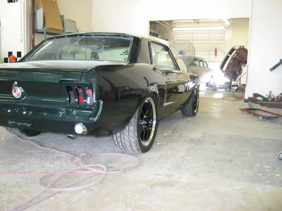

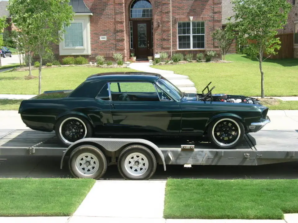

OK...actual proof that I do work on my car! Last weekend I trailered the car over to Mohr Restorations to get the paint touched up and buffed. While there we will also bolt the freshly painted hood on. After that all I need to do is get the trim installed before I get it tagged and registered. Any one here from Texas that registered their car as "antique vehicle"? I originally did not consider it because of the restrictions that are basically either parades, shows, or to and from getting serviced. But my insurance agent said that most people do this because the restrictions are impossible to enforce. The advantage is no inspections are required and you only have to register every 5 years. I have also bought some NOS unissued 1968 license plates that I will register.

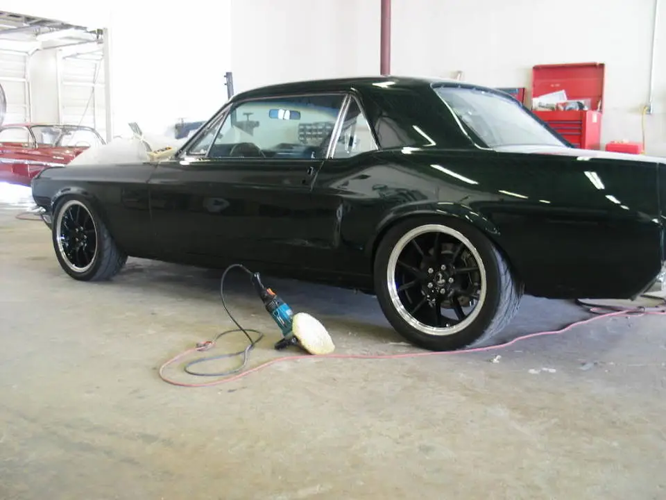

In the vid the rear tire is a 295/35-18 that I ran on a 10" wheels. They rubbed a little at my ride height so I changed to the 275/40 18x9 combo shown in the buff pics. The fronts are 18x8 with 245/40's. The supsension is Global West upper and lower control arms, GW front springs with one full coil removed and 1/4" poly spring spacer, GW rear springs dearched an additional 2", 1" front Stam Bar adjustable sway bar, and Koni shocks.

I gotta ask though - is that a buffing wheel sitting on the GROUND next to your car? That should be illegal next to a car like that!
Hi Jeff...didn't you recently sell your late model to buy some certain 67/68 coupe? You did the photochop of my car with the later model Ford anniversary wheels that were on your late model.
Good point on the buffing wheel...and a good thing he is done! I am going to pick up the car tomorrow...I can't friggin wait!

Your car has the perfect stance and the wheels and tires really set it off. So with the tires and wheels that are on it now do you have any rubbing, I was going to go with 255/40/18 in the rear but if I could fit a 275 that would look even better.
