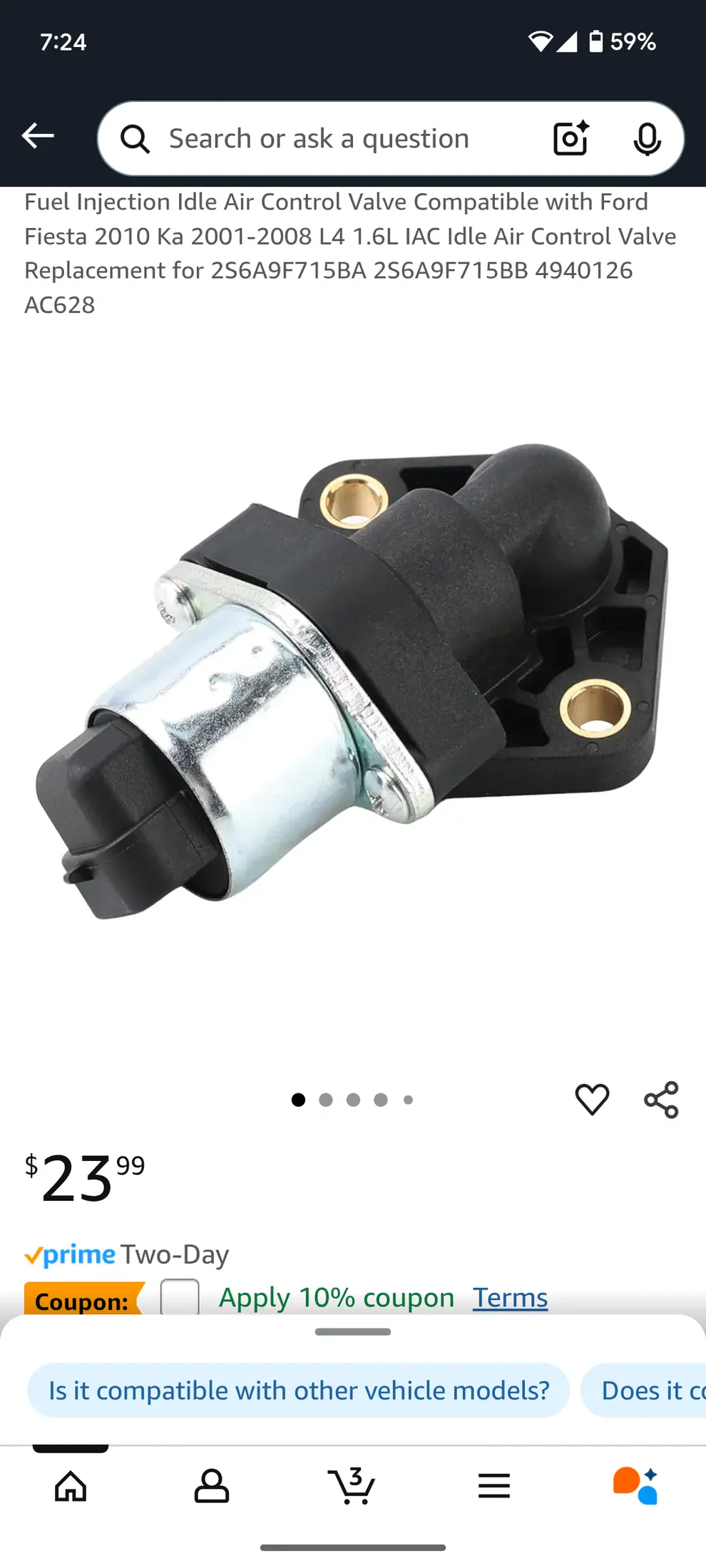

08 ish Ford fiesta....bolts to fox tb and has a gm style stepper motor.... Plugs right in to the existing iac plug on the term x harness(unless you have a foxbody specific harness with the ford plug).. But then just run the overlay and a new pig tail

Ooooh good call guys! I didn't even think about asking AI this question! Finally AI comes in handy beside weird videos of Will Smith eating spaghetti lol. Thanks @Kid wita 5oh I think that's exactly what I am looking for. I'll give this Fiesta IAC a shot next week and report back!

So I ended up giving up on this quest. Motorcraft IACs are nigh impossible to find it seems. I ended up pulling my IAC off and hosed the out of it with brake cleaner. I'm almost more confused now that I had it off and looked at the part number that is on it. It isn't anything I recognized but it appears that the previous owner pulled the motor and the valve apart, switched out the valve and body with a different part (potentially from a Focus or Fiesta, gonna keep looking to try and figure it out exactly) but re-attached the original fox body IAC motor. So far so good with it just being cleaned though, hopefully that will fix me. If not, I'm just going to swap to the 4-pin and run the new wiring back to the Terminator X ECU.

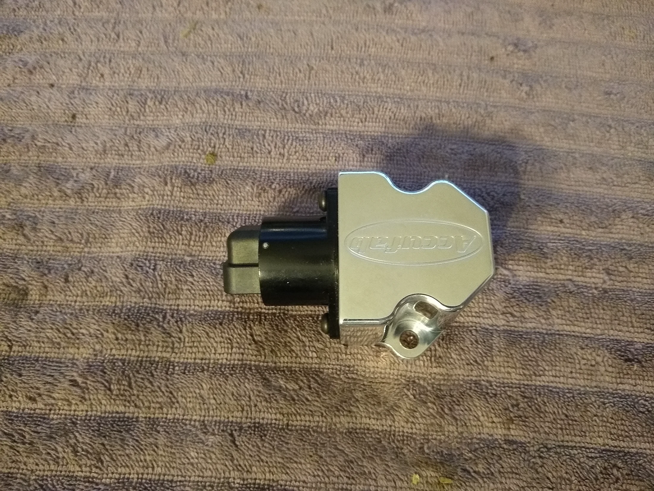

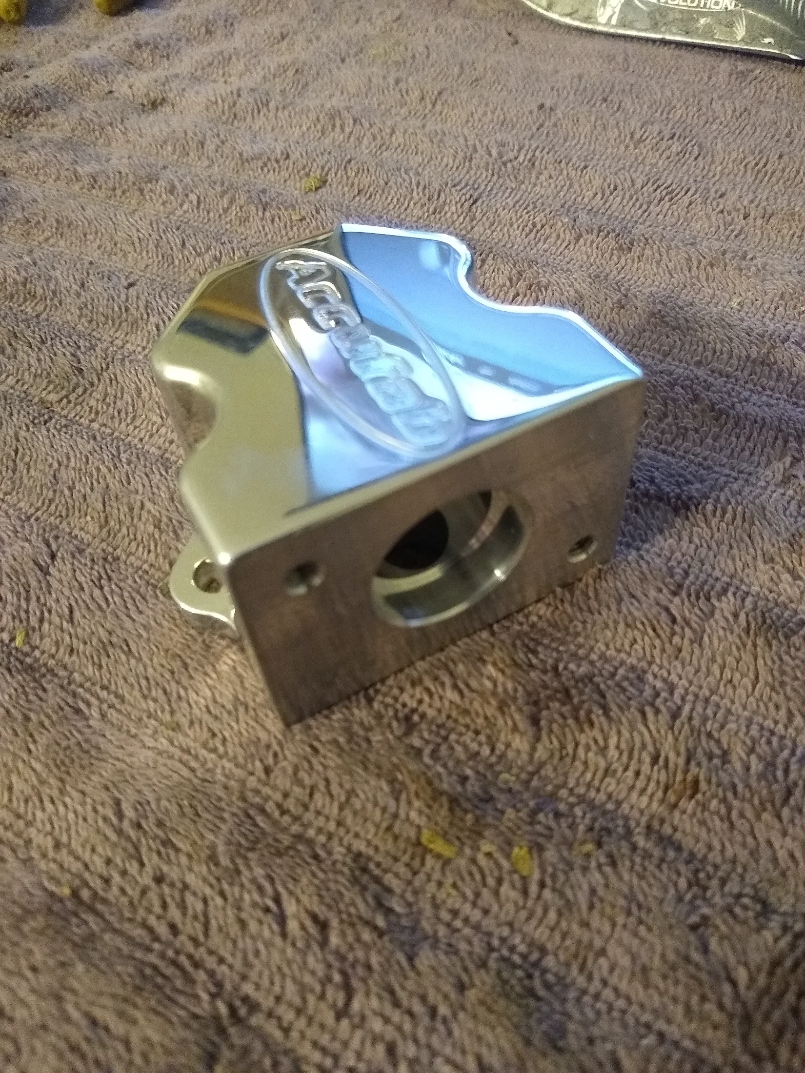

You need this IAC adapter to use a 4 wire GM style IAC....Its sold by ACCUFAB..............
Good Luck
