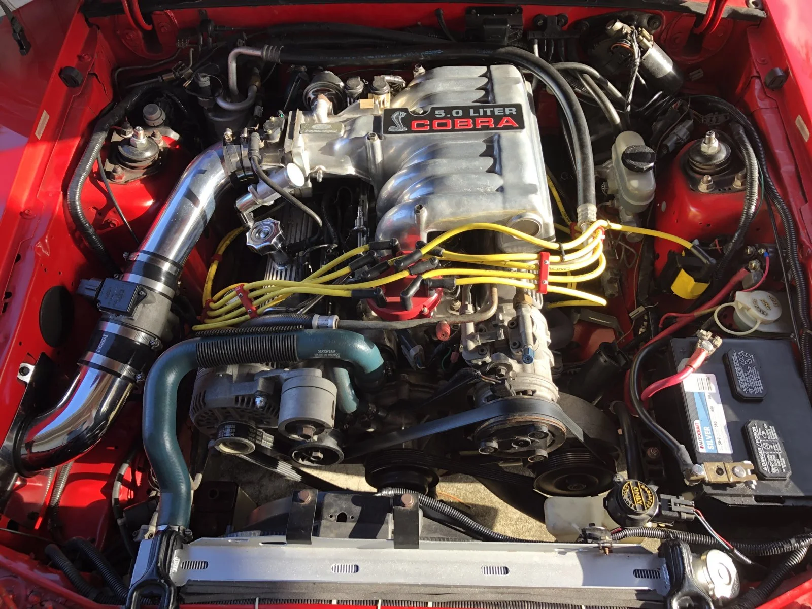

it need to be replaced.
are you able to determine which alternator (brand/model) will work for me as Plug and Play without making modification and other wiring based on the pic?
Just go to your local auto parts store and ask for an alternator for a 1994 Mustang GT. Should be a direct swap.
You'll need to swap your pulley over.
The SN95's come with a larger 3" pulley on them that doesn't work too well on the fox body. Larger diameter slows down the alt speed. Typically, you zip the nut off with an impact, remove the pulley and swap on the fox one. Everything else is plug and play considering you already have a 3G alt installed.

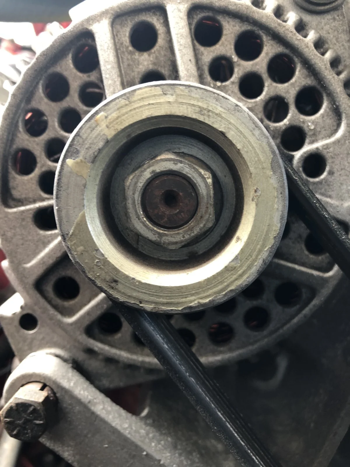

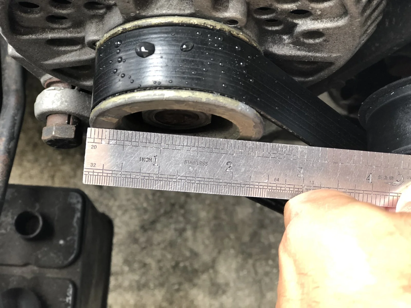

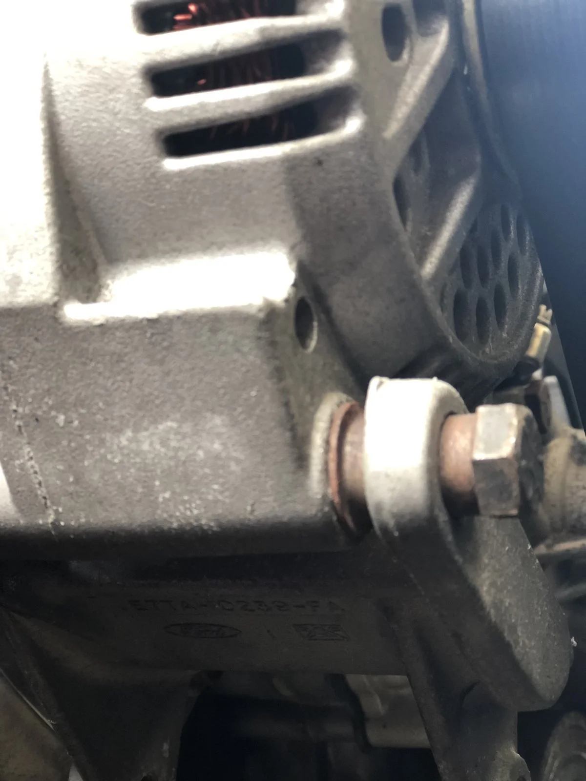

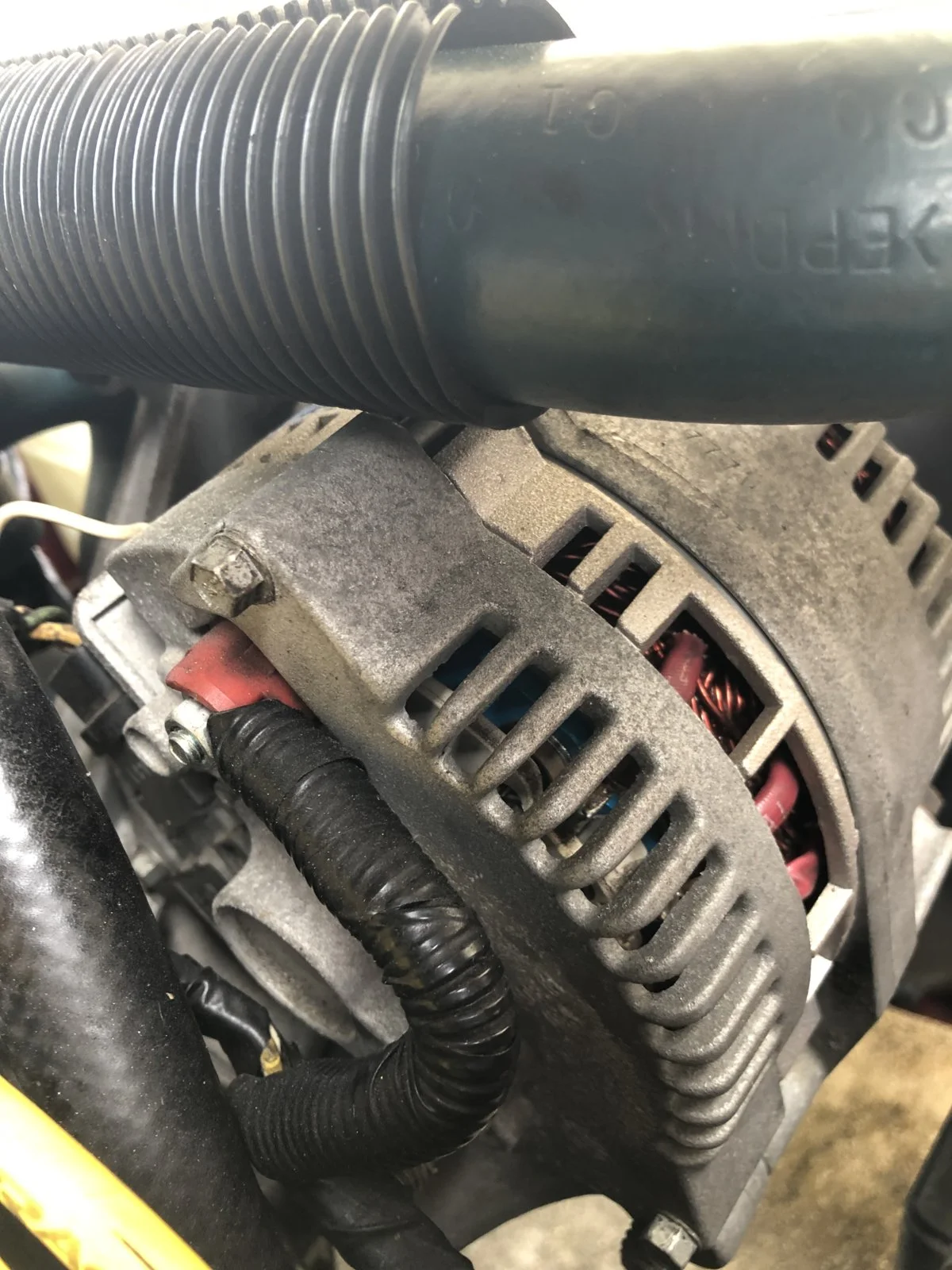

I took some pictures. please see attached. the pulley is 2 1/2 inch, so follow the comment above, i should use it on the SN95 model?
I tried to see which brand the ALT is, and I just can't find any logo :(
Iv'e talked to CJPonyparts, and they have 130AMP (PA Performance) but they mentioned I need to buy cable kit with it. (where this come from..?). my question, based on the pictures attached, can I buy the SN95 model (130 amp) replace the polley and just plug and play or a wiring job is involve as well?

Since you already have the 130A alt, you don't need the cable kit. The big wire hooked to the red connector is your main power wire.
Everything I see looks like a factory 94-95 GT alt that has been installed on a fox. 1 large 4ga power wire, one larger main plug, and a small white single wire plug.
Compare pulley size with the replacement alt. It's been some years but pretty sure SN95 alt pulley is near 3". I would swap the pulleys.
Once in a while you might see a sticker on an alt identifying it as a reman, but for the most part the 94-95 alt did not have any markings on it. My alt is a part-store 94-95 alt, and doesn't say anything on it at all. Can't remember what brand it is, but it's over 20 years old and still going strong
what was mentioned above, purchase a replacement alternator for a 94gt mustang from parts store and compare the pulley size. You want the smaller one so if your old pulley is smaller swap it onto the new alternator and your good. If yo use the larger pulley it will turn too slow at idle and you want get a full charge while sitting idling and you'll have flickering headlights etc. just swap to the smaller pulley of the two
