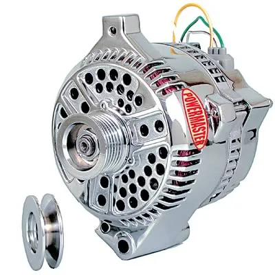

You mean like this:
It's over $300!
Ouch
Powermaster says it can be hooked up as a one wire, but the Summit description says no :shrug:

I just ordered this 100 amp Powermaster from Summit -
The info on Summit's site is wrong. They say it's not a 1 wire hookup capable, which contradicted info I read elsewhere on this unit. So I called Powermaster and they confirmed this one is capable of 1 wire hookup. It's Summit part# PWM-8-37100 and is $169.00.
BTW - forgot to mention that this alternator comes with both v groove and serpentine pullies.

I switched this weekend over to the Powermaster 1 wire 130 AMP and man did this make a difference over the stock 35. At idle now I am making 14 volts and for needing to go over 1000 Rpm to get it to start working my choke does that. Unlike others I just unplugged and taped up the connectors and with the 1 large wire still connected that goes on the starter solenoid the amp meter works as well. With the wires still in tact I always can switch back as well. :nice:
