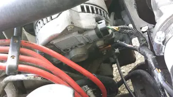

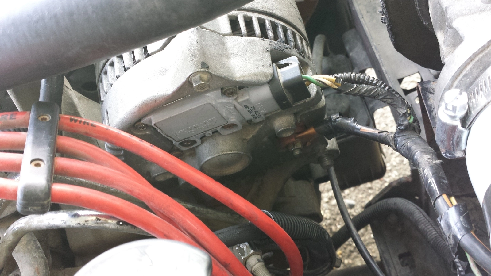

I cant figure out what my alternator is from. Im trying to get a replacement. Does anyone know what this is off of? My mustang is a 90 lx and I dont have the original wiring for the 90 5.0 so idk any help thanks
If the alternator doesn't have a external fan on the front, it probably is a 3G.
I noticed that it has a bolt on power wire, which is different from the original alternator.
I think that is a 3G alternator already. Of course, pics of the frontside would help.
But judging by the power wire post, looks like a standard 3G alt.
94-95 GT alt would be a replacement.
