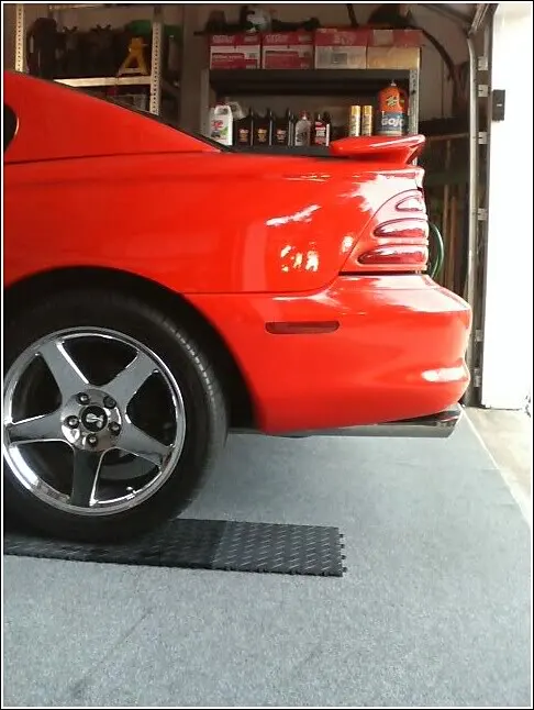

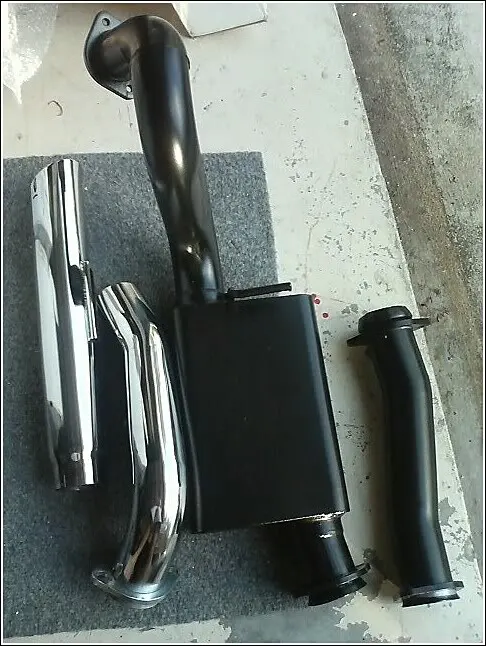

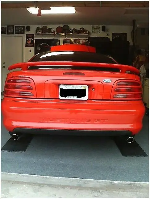

Pictures of system #2.
On the car.

You definately had me thinking about the MAC exhaust long ago. I love the three inch tips. I have 3.5's on my Flowmaster catback set up. Looks like 2 cannon barrels sticking out. Luv it. I should have gotten the MAC rig when I bought the Pypes system. I already had a mint Mac prochamber but it came out of a fox. Looks the same as the one you have for the SN. I think it will work. Mac says no. I damn sure would like to compare otherwise Im going to sell mine and go with the one designed for the SN. The MAC long tubes and prochamber are going on very soon. As well as the aluminum driveshaft. Car is coming along nice.
EDIT NOTE. I just compared the pictures of the MAC prochambers (Fox & SN) and they are definately different. The hangers are welded differently. So I definately must sell mine and purchase the SN model. :bang:
