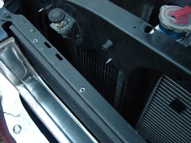

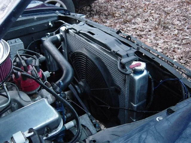

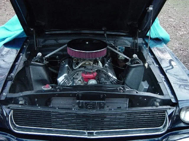

Northern 19x27, opening widened to expose the full core of the radiator, 73 bronco upper hose to top drivers side, mystery lower hose to pass side bottom (picked it off the shelf at NAPA). Top mounting bracket is a shortened upper mount from a granada, kinda did it the hard way, would have been easier to make something from flat stock. Easy install, works great. Since the battery was moved to trunk, and the metal on the core in that area was a little rusty, I cut it out and mounted the tranny cooler there, you can just see it in the 3rd pic. Hope this helps.
