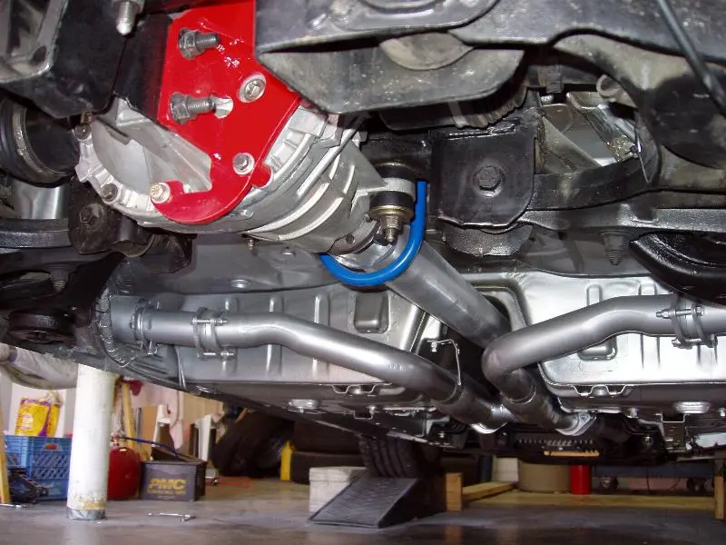

My complete drive train is new. The last item to be replaced was the drive shaft, since I had vibration above 80, and very bad above 90. I installed a aluminum drive shaft last month, and it is as smooth as silk. My aluminum one is 9 lbs lighter than the factory steel one. It looks nice also.

They probably have a better balance than the factory shafts. Whataya think? Are they a larger diameter? Do they need to have a better balance?
