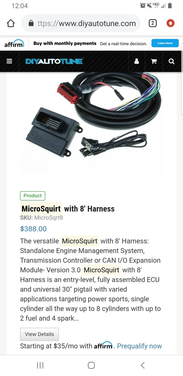

Your car will need to be tuned somehow. Chip or stand alone like megasquirt or Stinger Pimpxs. The later being the most versatile. A microsquirt will run your set up easily but has less features. I run mspnp2 in my turbo fox.

The micro squirt isn't that bad. Best bang for the buck. This replaces the stock ECU and is tuned by laptop.
This thing will need to be wired into your harness but there are tons of guys here that can help with this.
To run successfully you will need
1. Megasquirt
2. 255lph fuel pump ( my 340lph came from amazon less than 80 bucks....340 was overkill I should've gone with 255lph )
3. 30lb injectors
4. Wideband o2 sensor ( I use an lc2 wideband )
You don't need the MAF with microsquirt. That makes it almost pay for itself. This microsquirt will run just about any v8 that doesn't have vvt. 302...to big block chevys. Will run your lawn mower too.

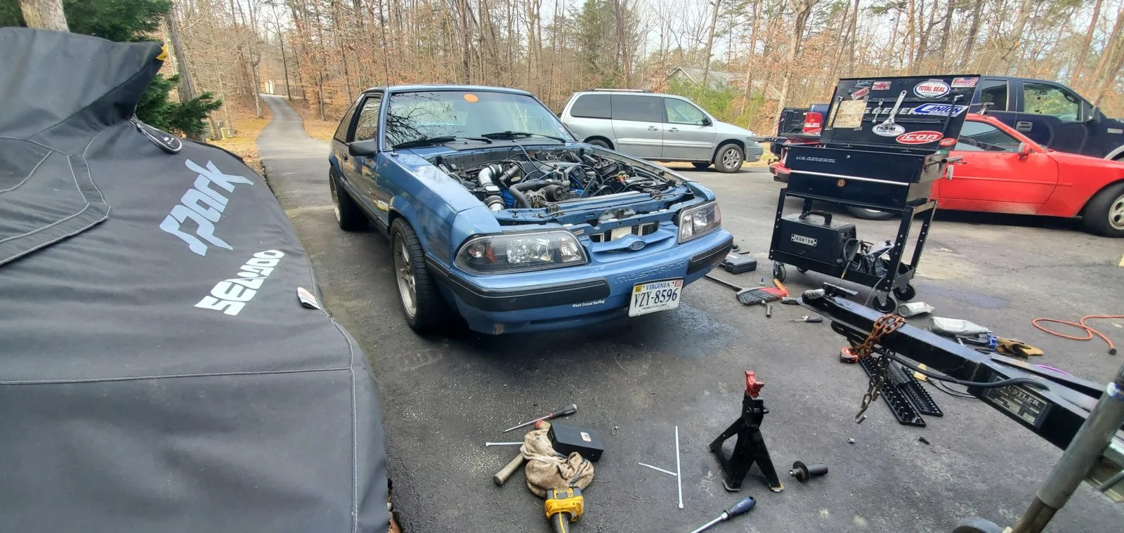

I just built a 331, got it together last fall. Broke it in on 24# injectors. Car actually ran great,besides a surging idle. Ran a bit rich,I blame the BBK maf meter. I just wanted to put 100 or so break in miles before I added the turbo and mspnp2.
