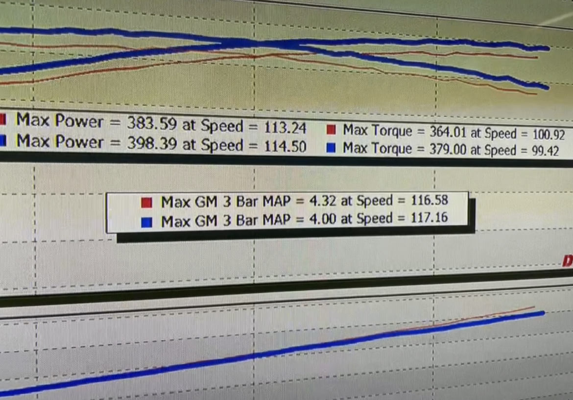

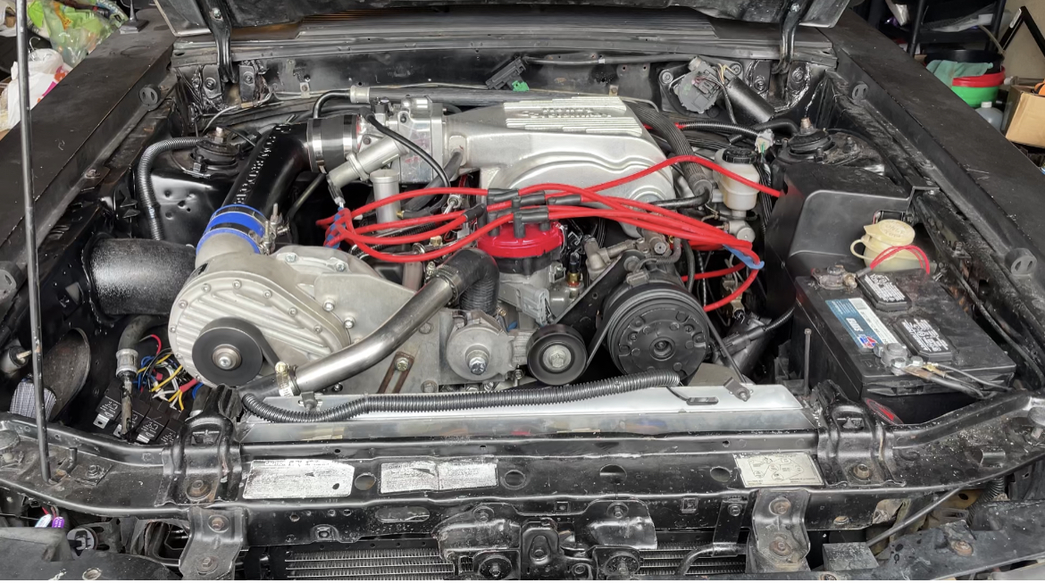

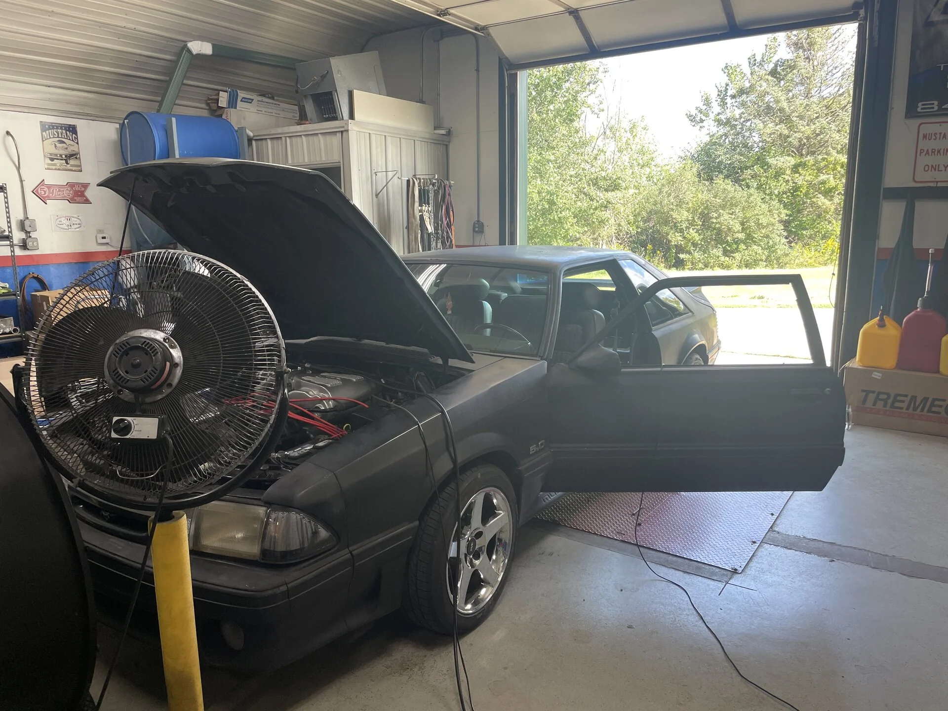

Sunday I got my 87 Gt dyno tuned and I much say I’m pretty surprised by the results. I was expecting less esp on a conservative tune and by :poo:ty powerdyne only pulling 4lbs of boost. With air conditioning lol. My mods are
Holley Systemax 2 intake
Twisted Wedge 170cc heads/valve springs
Anderson N-41 cam
Siemen Deka 60lb injectors
Full exhaust
Powerdyne 6psi pulley with UPR power pipe
3:73 gear
Holley terminator ECM
398HP and 379 ft lb of torque on a stock bottom end is pretty impressive in my opinion. What do you guys think?

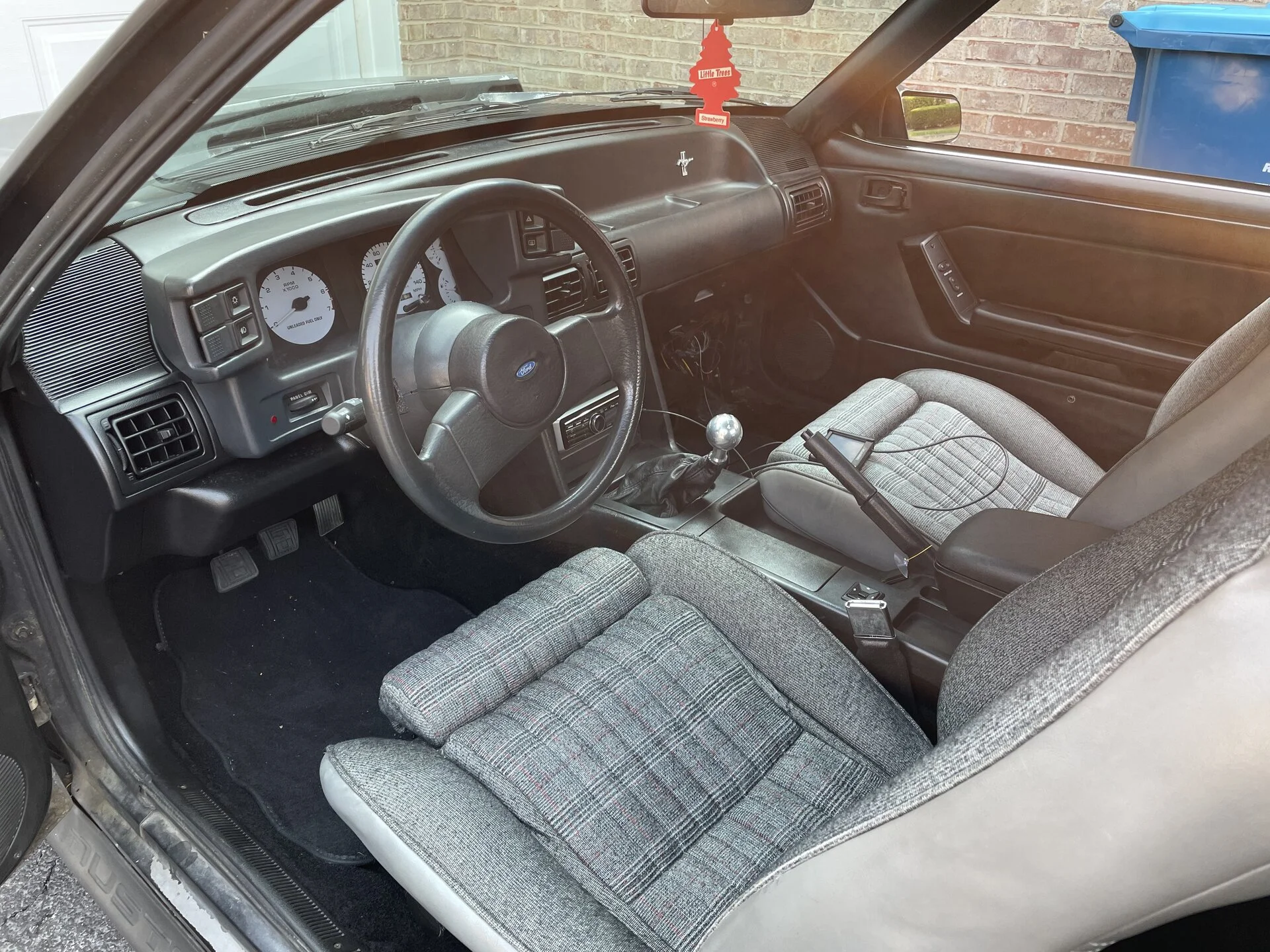

Lmao it’s a very fun car to drive. It doesn’t get driven like it should. with being as busy as I am and working on it all summer I may have put 60 miles on it all season. At times I’ve even lost interest but those numbers made me very happy and once it gets painted over winter I think I will be very very happy with it. I just finished the interior before the dyno tune. Don’t mind the missing kick panel lol that’s where the Holley terminator connector is for tuning purposes.
