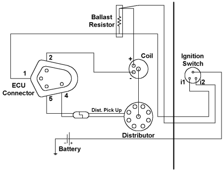

yes, dont buy the msd box. good box for sure, but i have a better ignition system for a lot less money. i used the chrysler orange box oyu can get from summit racing, or any chrysler dealer. you can get the wiring harness from summit racing also, and the hook up is easy. if you want the wiring diagram forthis conversion check out
by the way for the ignition box to dist connection, the black wire is a ground, and for the other two, it doesnt matter which of the two pins 4 or 5 you connect the remaining wires to, as long as one wire goes to each pin.
for the text check out this link;
http://www.gofastforless.com/ and click on electronic ignition. you might have to use his "loser index" if you dont have java enabled. it is at the bottom of the page.
