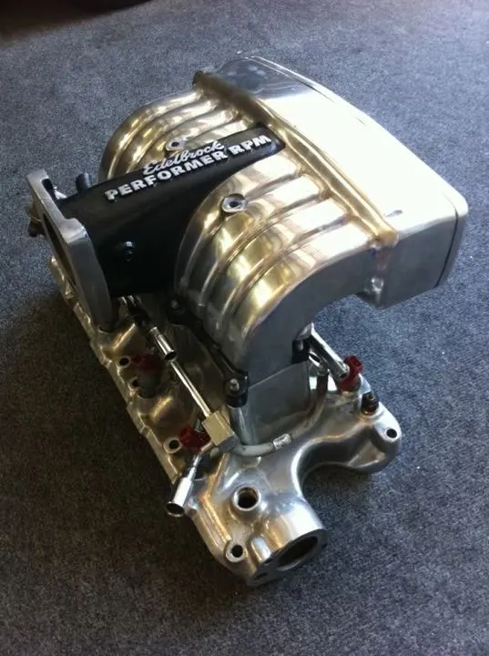

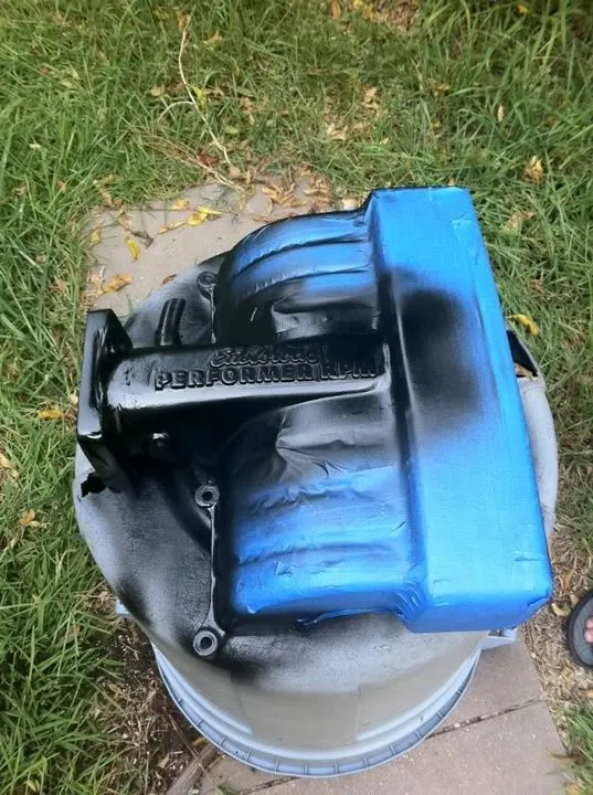

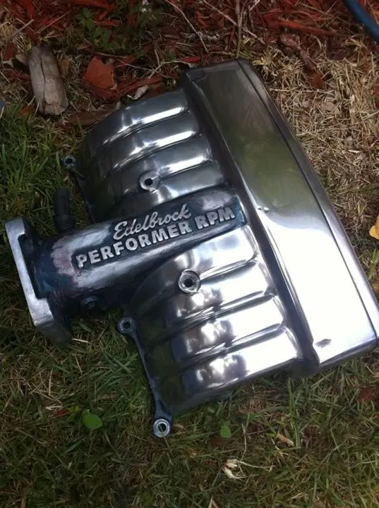

You could always strip the stock ones and then polish them. They would look much better. If my rockers fit under the stock covers thats what I would have done. I'd paint the fins color of car. Saves you $120 too. It does take time though so air tools-die grinder with sanding disc, then move to 220 grit (go with grain), move to 600 grit, 800 grit, 1500 grit wet sand then polishing wheel, done. Sounds hard but not too bad. Intakes take longer.
I didn't realize that they are alum and could be polished. I did some work similar to your intake for the intake on my GTI years ago and it came out great. The only challenge was it needed to be cleaned and polished often. I am not sure how much access I will have under the GT40 intake but that is good to know.
