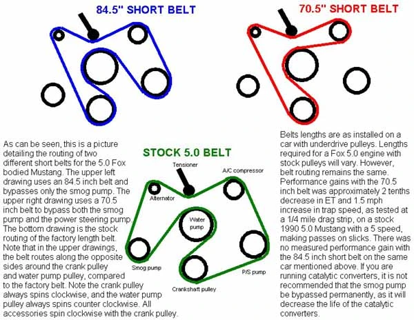

Here is a diagram on belt routing and short belting if it helps any
http://www.fordmuscle.com/archives/2000/02/quicktips/index.shtml

Thanks 89sleeper
I didnt look at it that way and i would have never thought of that myself you fixed the belt squeeling, I ended up with a 32 inch belt and it fit nicly.Now only if i can get people to reply on all the questions i have it would be a breeze. thanks
