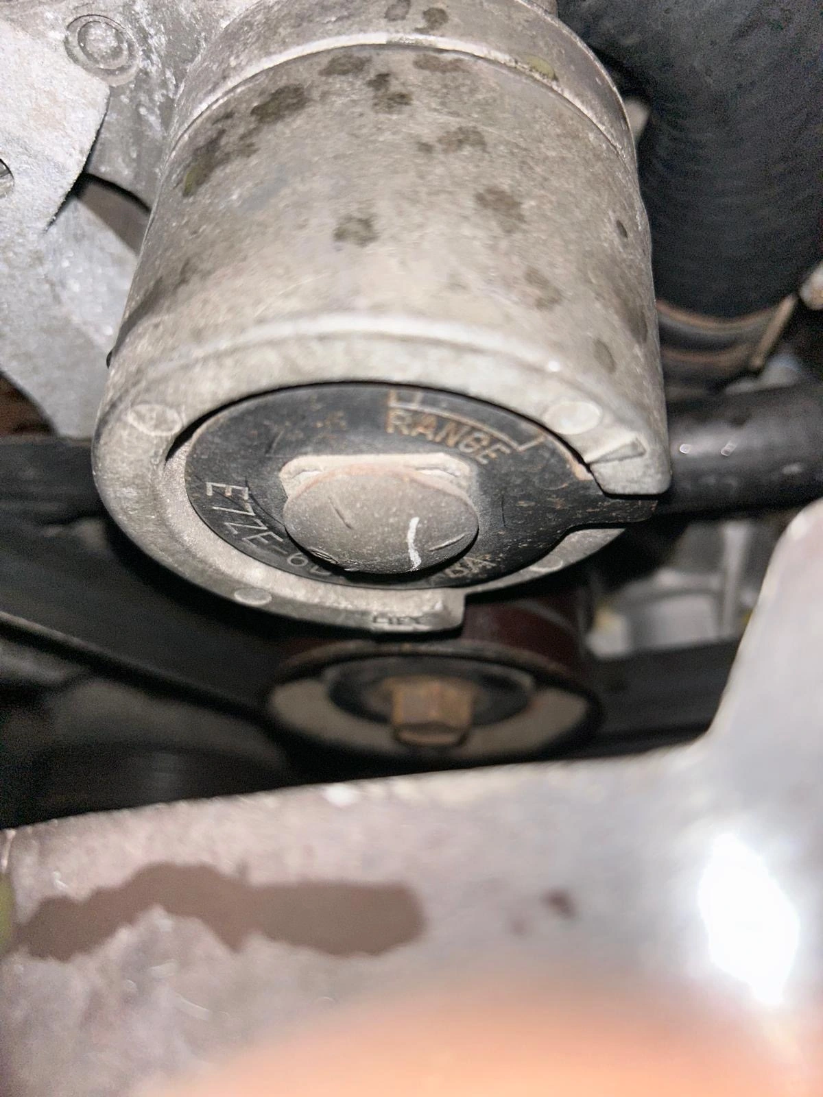

if the belt is in good shape then it’s a pulley issue either out of alignment from install or just worn out. The tensioners can also have issues on the pulley and in the tension. Where is yours in the spring range on the tensioner with the belt installed?
Thanks for the reply. Here is mine

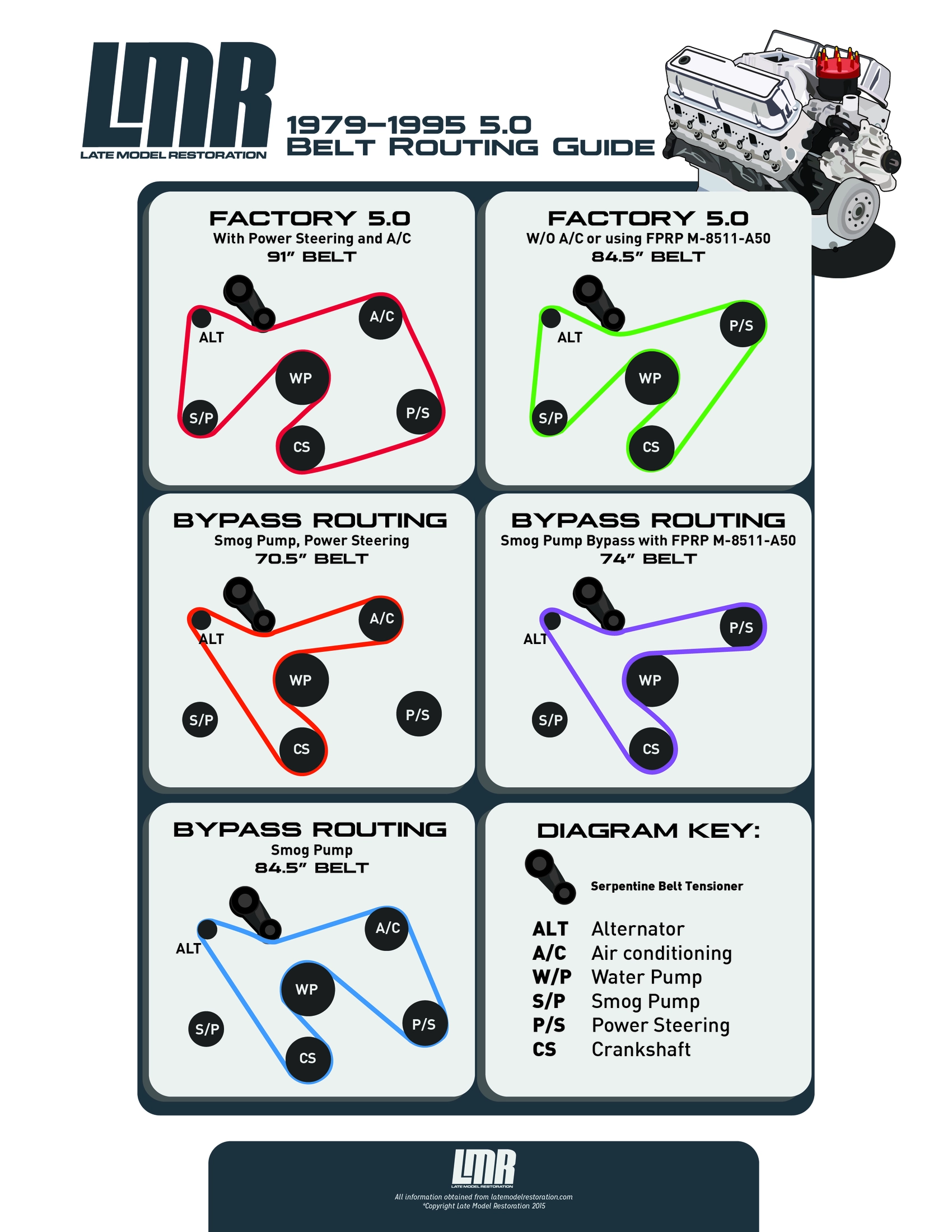

Have to remember these lengths assume stock pulleys too, aftermarket ones will change the lenghts, I typically run a K060832HD gates green belt which is 83.2 ID length. When bypassing smog pumps using Typical street under drive crank and water pump pulleys and a 3g swapped in. Stock a/c and either stock power steering or a march billet pulley.

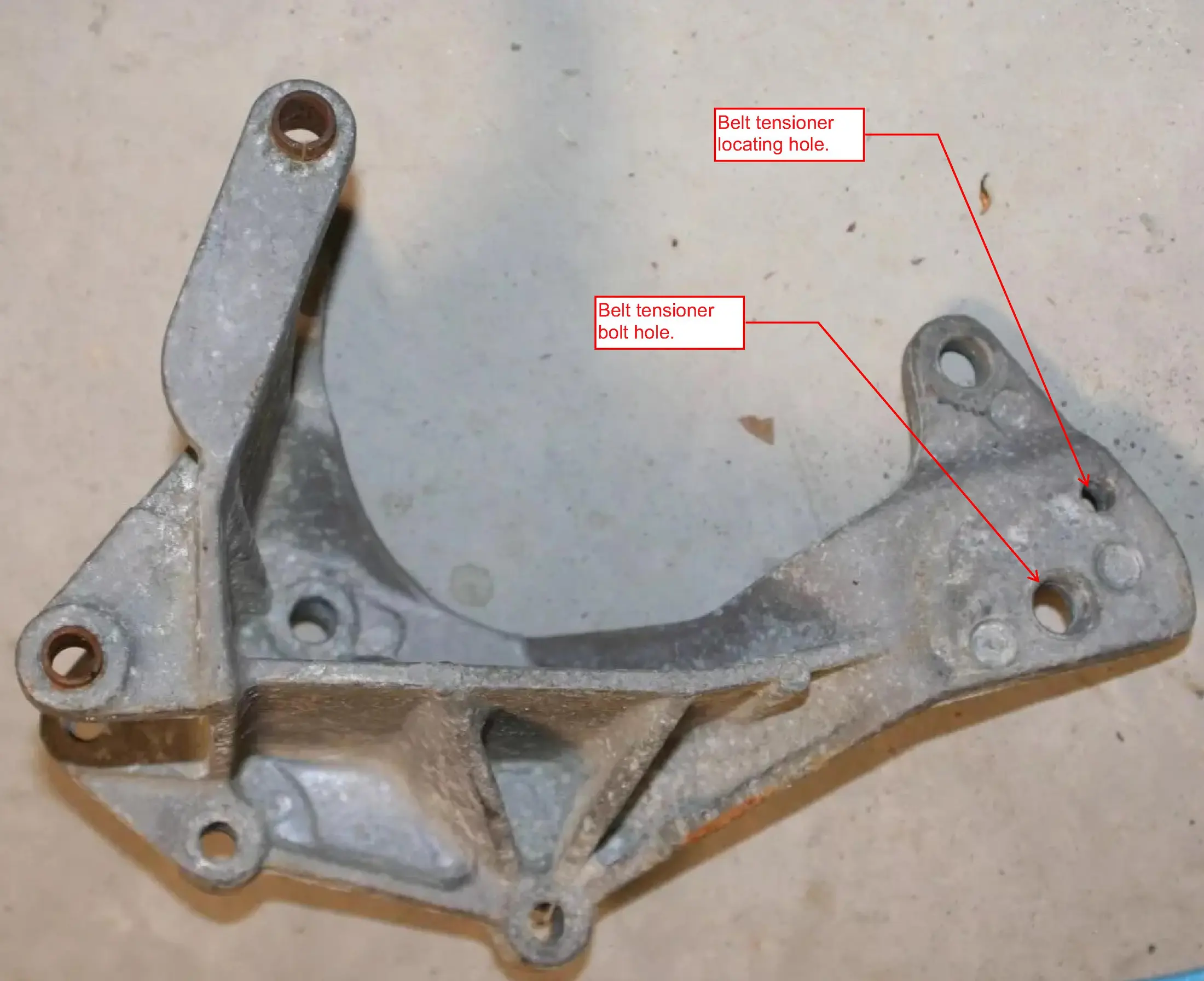

So there is a post on the back of the tensioner that positions it on the bracket it attached to. Make sure that post is locked into the correct hole so that the tensioner is correctly positioned and can actually create tension. If it is installed correctly then you need a new tensioner or a different length belt.
Bracket without tensioner installed:
Bracket with tensioner installed:
New tensioner won't help its all ready out of range because the belt is too long. If you need to muscle it against the spring tension to move the arm, the tensioner is fine, pulley might not be but that belt pictured is too long. They also have a locating peg so pretty hard to install wrong, mounting bolt is also reverse thread so no righty tighty lefty loosey unless you want to snap it.
