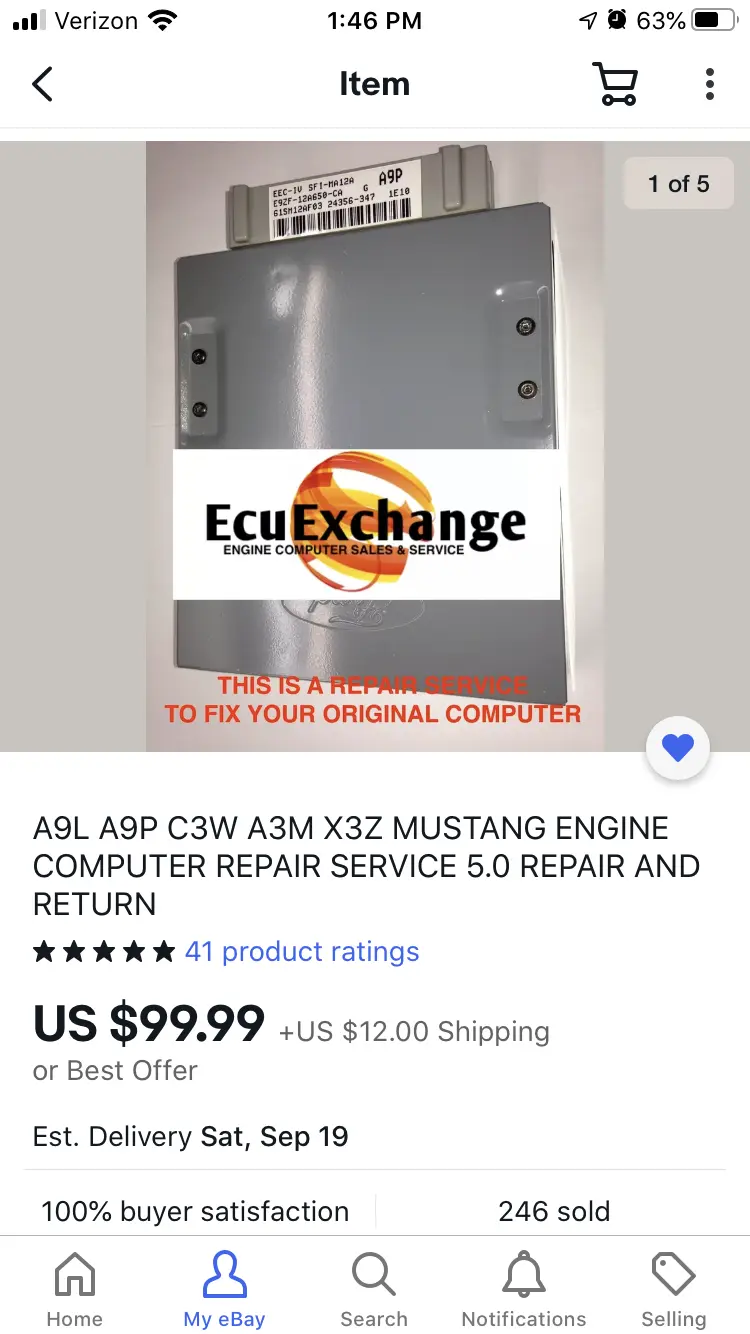

If you are in doubt about replacing caps or if it still is goofy afterwards, these folks have been good to work with.
