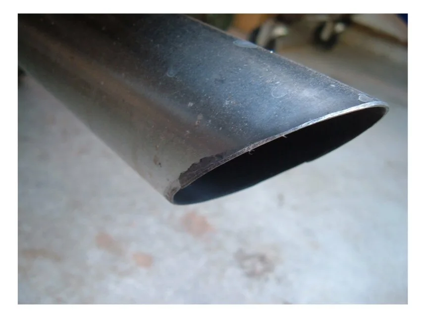

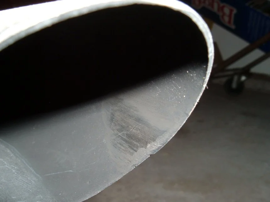

Ok I have been on here before asking about pinging. I have a 94 Mustang GT Conv. I have replaced the IAT, cleaned/checked MAF, checked O2's, replace spark plugs, etc etc.. (The car is bone stock for proformance also) We stepped the timing down to about 0 (spout out). It is really slow and bogs down and it still pings on mid grade 89 oct. gas!!! :fuss: But I noticed that the exhaust smells almost like diesel gas, coming from the tail pipes. Also around the outside of the pipe it gets really black, like a carbon build up. I wash the car about once a week and it comes back every time. In the picture the car was washed yesterday. It works its way towards the front of the car along the tail pipe about a 1/2 inch. Also the inside of the tail pipe is really really carboned up. I cleaned a little spot as you can see with my finger to show the build up. I'm guessing all this is caused by being super lean. It pings when you are about 3000 and up and more than 1/2 throttle. Which makes me beleive the fuel pump is not getting the pressure there. We also replaced the fuel filter. Should I check the pressure at a dealership or is it something else.

If it really sooty looking, I would say its rich. Whats the plugs look like? How hot is the motor running? I would run the codes on it and go from there. There has to be something in the ignition or puter.

I dont know man. my pipes look darker than that. Do you still have the cats on it? It will smell weird without the cats.Try checking the timing advace. By that I mean check it with the spout in, and just rev the motor up some say 2500 or so and see what the timing looks like.I dont know what the stock curve looks like, but with my chip it goes to like 34 degrees total. Other than that only thing I can think of is its running to hot, that will make one ping. You running the stock gage? Good luck , I feel your pain!
