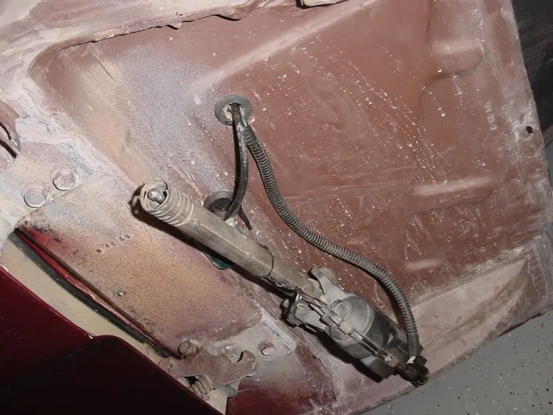

Here is mine, (with the fender removed)
Thats a sweet modification. I installed an OEM NOS Ford antenna for a Granada on mine. I wanted the stainless whip style instead of the solid mast style. I like the power antenna idea. I had always dismissed that idea before, because I didn't know how well it would work.
