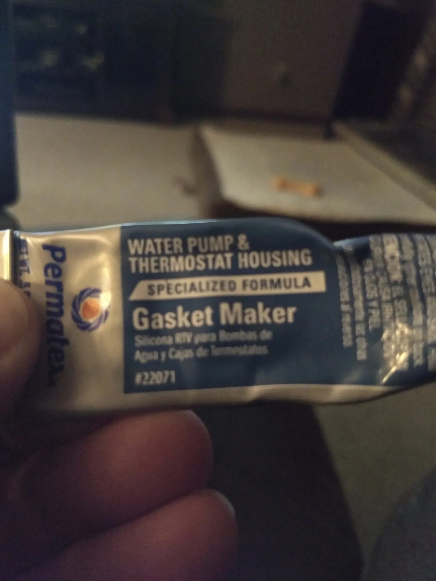

I understand the shop is far from you and you would like to fix it yourself, these leaks are a p.i.t.a., Clean really well, use good rtv on both sides of gasket and on bolts , if this fails take the trip back to The shop and let them have at it.

I had an endless leak on my Tacomas thermostat housing and I did not realize that most gasket sealer-makers dont resist anti-freeze. I got the special stuff that can handle anti-freeze. Thats how I finally fixed it.
This. They make a special sealant just for this. Comes in a small tube,works awesome.

You want to use surf glue on the thermostat gasket...blue permatex....put a little to hold the thermostat in the housing first. ( just the metal that goes in the recess ). Let it sit for a few minutes to hold the thermostat in. Then coat both sides of the gasket and put it on. If the bolts go through to coolant ports they may need sealer too.

Either Permatex form a gasket #2 or #3 is a good solution for water pump and thermostat gaskets. I used 3M yellow weatherstrip adhesive on both sides of a thermostat gasket once, and it made an excellent seal. If the gasket had not ripped for disassembly, I would have never got it apart again. ;-)

I've seen some 20$ thermostat gaskets, has anyone ever used them? & could 1 of them help my leak issue? Thanks for all of the input i've already been given.

It's the stock housing & bolts, I installed it just the way u said, minus the permatex on the side of the gasket mounting to the lower intake, I was told to stay away from doing that?

Make sure the bolt holes are clean, the surface is flat on the intake side, look at the bolt holes to make sure they have not pulled out from over tightening, smear a little rtv on one side of the gasket, make sure the t stat is oriented correct ( some have a bleeder hole or a little gizmo that is like a loose plug, very small, this should be at the top) and put the gasket on the housing with the t sat in place, let it sit for a half hour or so, make sure the t stat is still in place then smear a little rtv on the intake side of the gasket or the intake it self, install the housing to the intake tightening the bolts evenly, I could not find a torque spec in my magic book but it's not a lot. Snug one bolt then the other going back and forth till tight. I let stuff set over night but a hour or two is sufficient.
