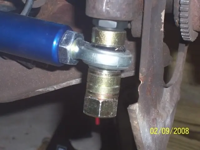

Here's the answer for adding H&R sports for an 1.5" drop with no bumpsteer. There's no other bumpsteer parts accept this Steeda bumpsteer kit. This was cal'd with a bumpsteer gauge.
