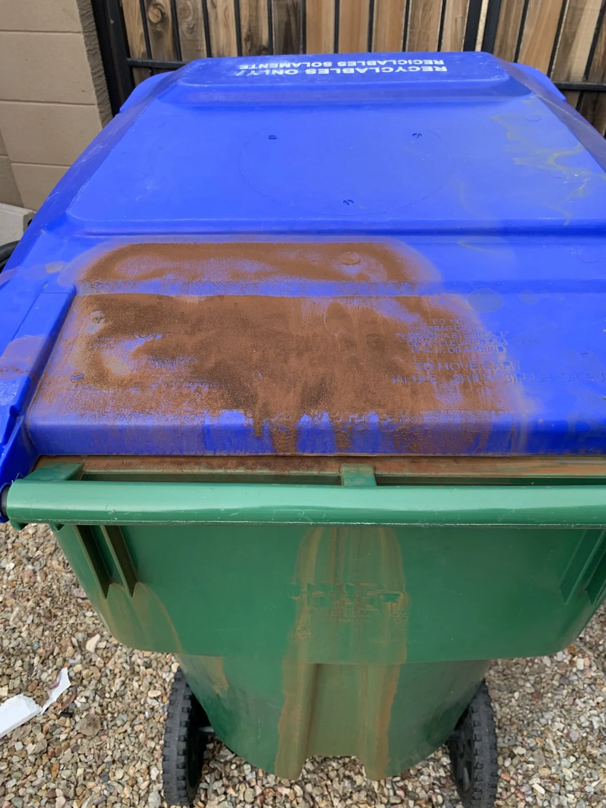

My fuel tank “issues”... That :poo: sitting on the garbage can is what came out of the filter.

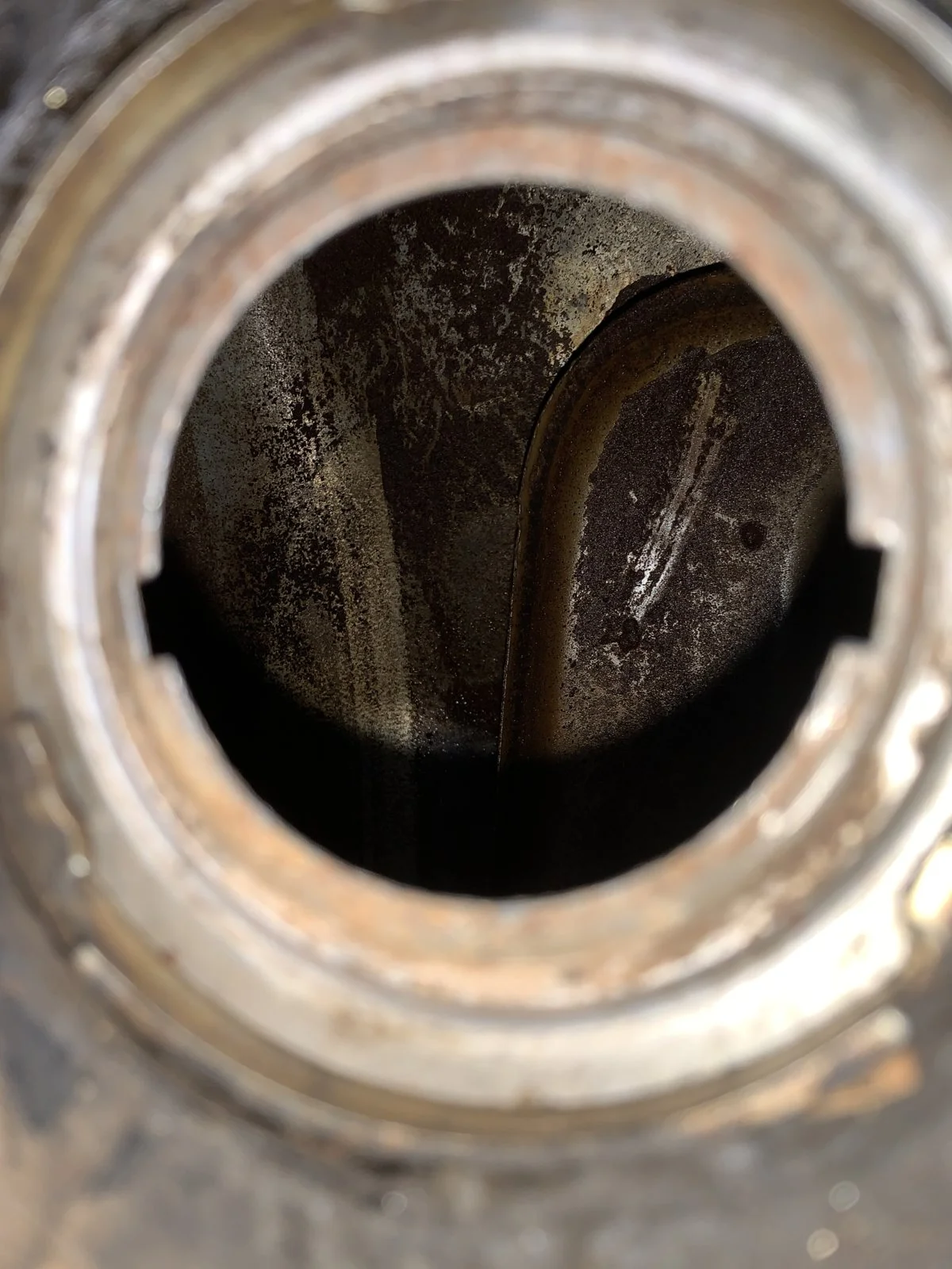

Inside of the tank was filthy and the baffle was completely broken.
