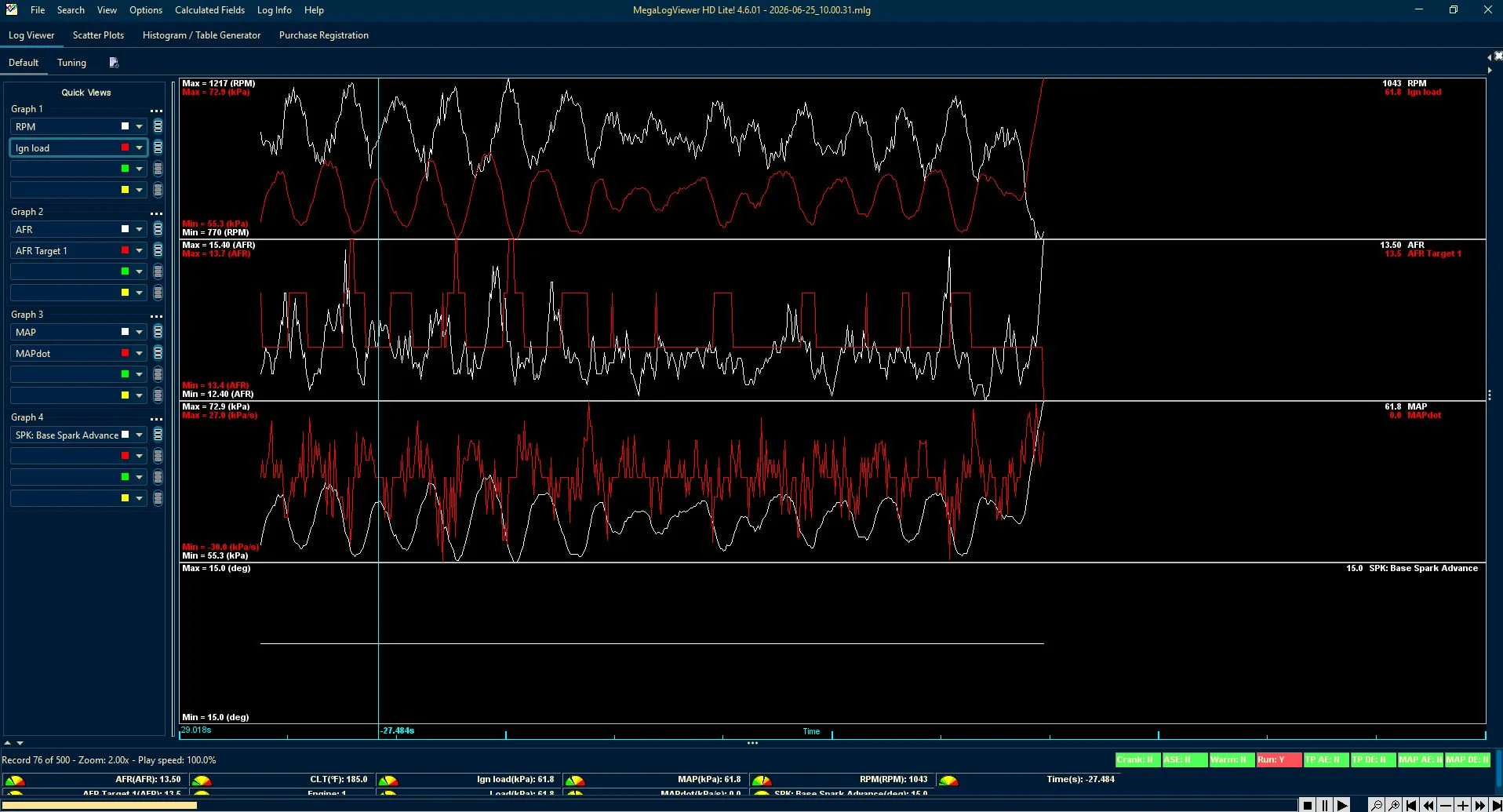

I have attached a data log, not sure if you can see it or not, but im able to view it which is weird.
In this log the fan turns on right at 190, of course the one log i try to record it shutting off when the fans kick on it doesnt.

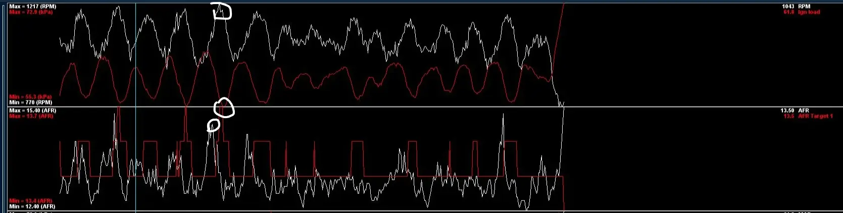

Not sure if the screen shot of the log helps, I have no clue what im doing when i view those. Just tried to match everything together.

One thing I see. I can't open the log (due to being at work on a different PC) but looking at your screen grab, i see your oscillations are somewhat related to a rise in AFR and a rise in target AFR.
I can't see what VE cells it's bouncing between but it look like the AFR goes lean. usually a lean VE cell causes idle to climb. I think you are pulling fuel to drop the idle but I think you want to try the opposite here. Add a tiny big of fuel to the low VE cell and see if that settles the surge a bit. Then you'll want to add a bit of fuel into the cell that the idle is surging up into to fatten that up which forces the idle down.
Kinda circling example high points.
Also your AFR target is surging as well. As you smooth idle out you might want to align the cells so that your target in idle is the same.
The high idle itself might be something with the throttle blade angle, or a setting in the idle steps. I'll need to take a look later
