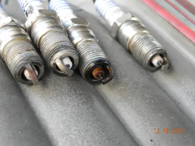

the problem got worse. under light accel it would begin to shake. almost as if you were starting from 3rd at a red light. I began pulling plugs. this is a whopping 1100 miles.
so I did a compression test
and had a big 0 psi in #3
so I pulled the valve cover and found that I broke the spring in 2 places

Broken valve springs and stuck vlave usually show up as a sweeping reading when the engine is run at 1000-1200 RPM.
Surging Idle Checklist said:
" A vacuum gauge will help pinpoint both vacuum leaks and improperly adjusted valves. A sticking valve or one adjusted too tight will cause low vacuum and a 5"-8" sweep every time the bad cylinder comes up on compression stroke."
It is listed on the second post on the Surging Idle Chekclist after the setting base idle procedure. Now you know why I keep pushing this troubleshooting tool.
