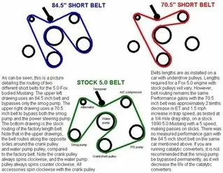

hey i have a 89 LX 302...I just removed my smog pump and A/C. I have the Ford Racing A/C delete bracket in, that relocates the P/S pump up.
Does anyone have a ruff idea on what size belt i would need to use?
String it.
Honestly...it's the easiest way. Everyone has different pulley and accessory combos so sometimes it's tough to find someone with the exact same setup.
Just run a string around the pullies, measure and buy a few sizes around that lenght. Belt part numbers usually tell the size. They may go 4060935 and the last 3 numbers would usually tell you it's a 93.5" belt.
Just save your receipt so you can return them :)
hope that helps!
