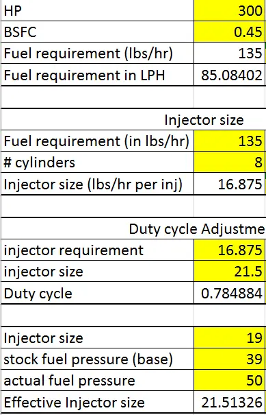

Trying to identify if I have fuel issues. Suspect I have a week fuel pump (stock) and looking to replace it. But while I am at it, the injectors are stock 19lb. Wondering if there is any value in upgrading those on a NA motor.
I have a Edelbrock Performer intake and heads, E303 cam. Car should be near 300hp at crank still have to Dyno it. But just wondering if the 19s are border line on Max cycle duty since they supposedly rated to 270hp, with a 15% buffer.
And if the cycle duty is 100%, what does that mean exactly? I'm just wondering if upgrading to 21lb would be a better fit. 24lb seems overkill for my setup as I have no plans to change the power.

19lb injectors only flow like 21s if you up the fuel pressure.. and thats at max duty cycle.. if your gonna swap pumps and get injectors.. with your setup the 24s will be good.. and give you room to grow for future upgrades.. Im running 30s and its just what i needed for my setup plus it gives me decent room to grow. or atleast until i install my turbo ill be goin 60s.. go with the 24s..
Skip the 24s, and go straight to whatever size you think you may need eventually. People have always idled fine with the old FMS 42 lbs injectors. Now, I've read that some people are using the stock EEC with 80s. If they can idle and put around, so can you.
Another band-aid solution is to bump fuel pressure up, assuming you can. You'll still need a calibrated MAF, or some adjustments in the computer, but if you bump it up to 55 psi, 19 lbs injectors are roughly equivalent to 24s. Without a calibrated MAF, it'll be extremely rich at idle. The pressure makes it harder on the fuel pump, though. So, you don't want to do that on a stocker, but any bigger aftermarket pump would handle it fine.
People are only able to idle with 80lbs injectors using the stock computer is when the computer is superchipped.. or heavily tuned.. the stock ecu doesnt have the adaptive stratgey to idle at that low of a pulse width.. so you would need a dyno tune with 60s or 80s... the stock ecu can handle up to 48lb injectors and idle fine with the matching maf.... after 48lbs your gonna need a tune.. also bumping the fuel pressure sure you can run 19s like 21s.. but like i said thats at a max duty cycle of 100%.. barely any closing time for the 19s... just go 30s and be done with it... room to grow,, and you will idle fine
