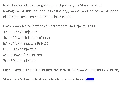

I was searching on the vortech site to find any recommendations, I found this chart on the calibration discs page. I figured I'd post it here in case this came up again:
Looks without any active fuel management from a more advanced computer, they intend for you to use a FMU the whole time.
The natural follow up question is that if 30lb injectors can support ~350hp in a n/a application is there an additional "differential" you have to add to that for a boosted application? Like once I have all the necessary supporting parts, will I still need to upsize? I may just flip what I bought and get a AFR guage instead to be safe. I thought I had gathered all the info I needed before I made a purchase but I was clearly missing some important bits. If these injectors won't work final state, and they are not needed in the base kit, I might as well sell them and get the AFR guage.
