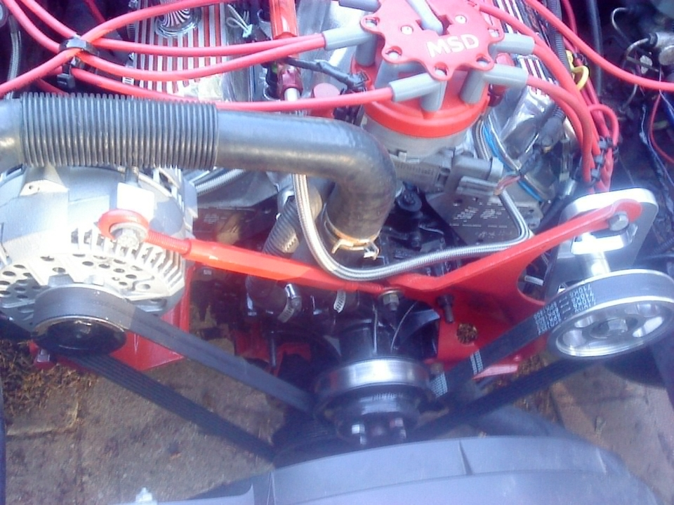

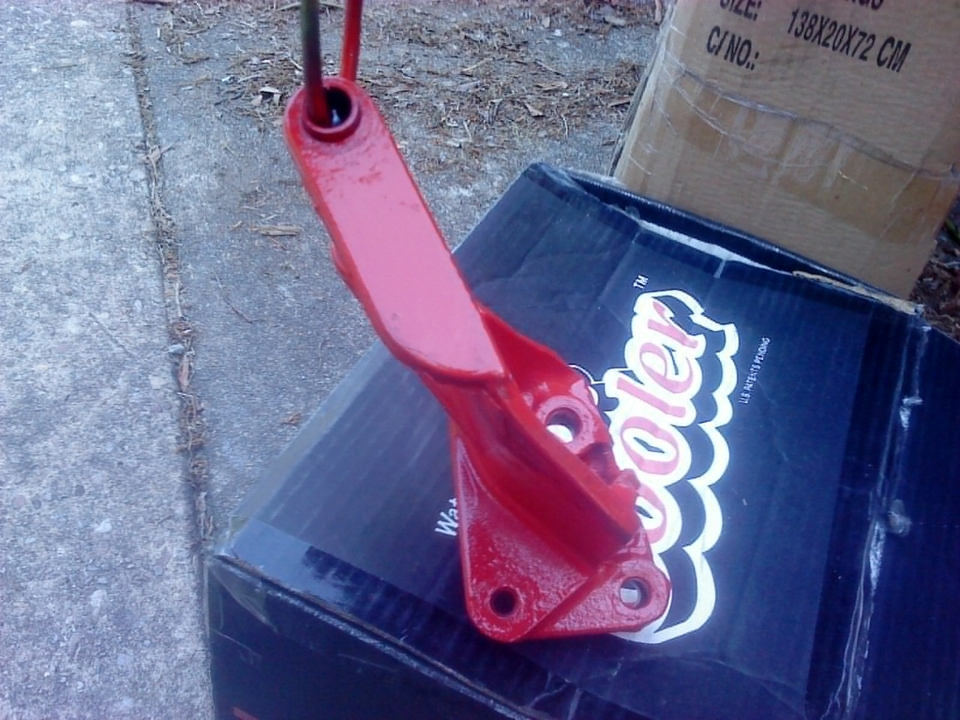

I have the summit AC delete pulley on the driver side & for the alt. I cut the bracket down until there are only 2 bolts mounting it to the head & the long bottom bolt of the alt. I then used a small turn buckle for the tensioner. I use a 710k6 belt and its routed to look like a v by going under the water pump to keep the correct rotation. Its a cheaper way to go & I will try to post a pic later.

here are some pics of my set up.

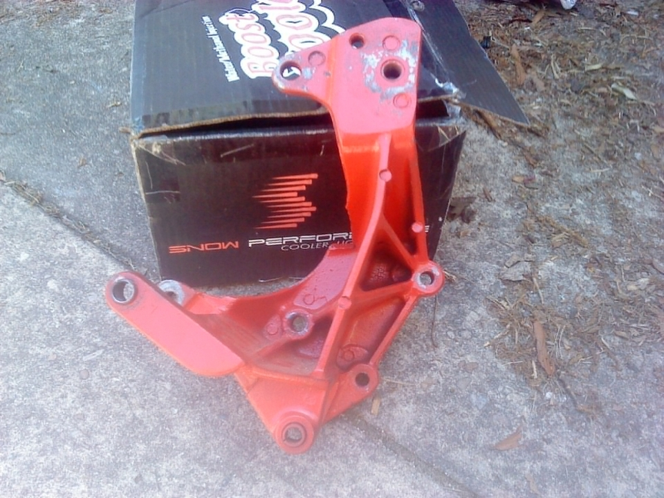

to me, it seems just like the kits that they have to relocate the tensioner except the bracket is cut different and those kits are around $30 but you still have to buy the rod ends to adjust for tension.why cant just just cut a bracket to fit the alt and be done?

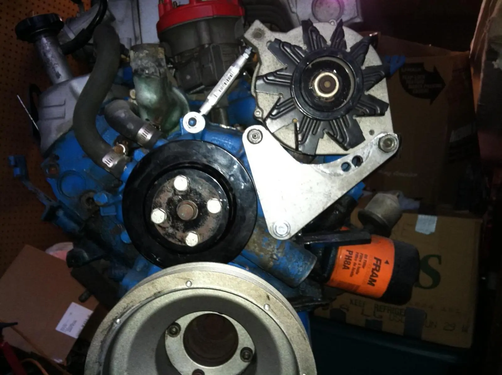

This is what I have got done so far. I cut done the A/C delete bracket that moves the tensioner and added a turnbuckle. When i finish dropping the motor in I will let you guys know how well this works..
