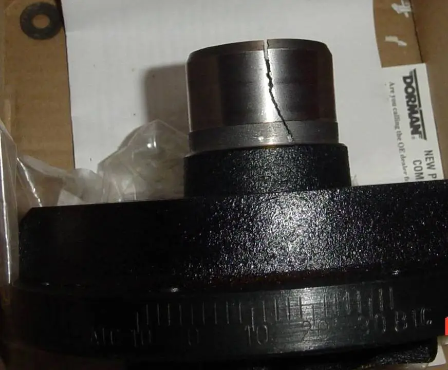

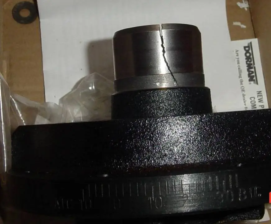

Last week I was adjusting my idle, and I noticed that my HB was wobling a little. There was no vibration or anything, but I decided it would be best to replace it. I put a stock replacement on it figuring that would be OK at least for a while, I put it in and all was well. No viration, and no woble when it was running. Today, about a week later, I finally got the clutch broke in from the new tranny swap, and I took a few acceleations at WOT through 3rd, and after that I could tell there was a significant vibration. I limped it home about 1/2 mile, and found out that the new balancer was cracked, and vibrating like a SOB. It seemed like the new one went on a lot easier than the stock one did when I put it on.

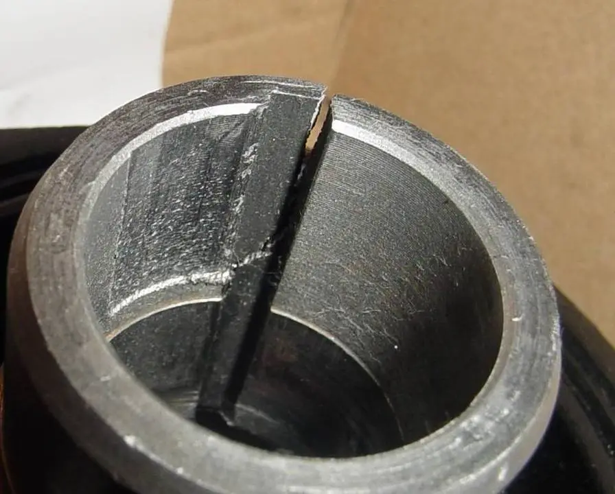

Here are the pics.

You could have had a disaster there! That balancer must have had a crack/defect in it from the manufacturer. Can you return it and get your money back? You should probably replace the front seal just to be sure it didn't get torn up by the crack.
I got the balancer from autozone a week ago. I am going to take it back today and get my money back. I looked at the front seal, and it looked OK, but I'll just replace it anyway to be safe.
Do you think it could have damaged my crank at all? And if so is there a way to check? It visually looks fine, but I would like to check everything I can before I get it back together.

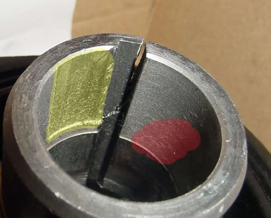

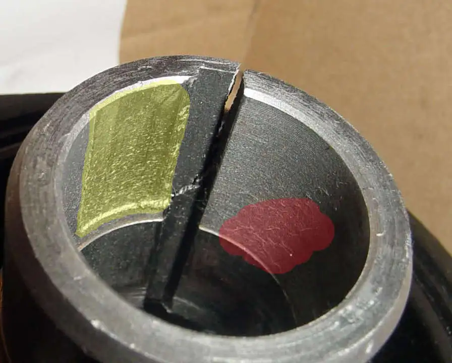

Great high-res picture. I'm a little curious about the area highlighted in yellow (below). It looks like something bad happened there. Like maybe the key rode up there. Is it possible that mark was there when you bought it? Or is it possible you mounted the balancer with the key off the groove (not likely because you said it was easy to put on)? Or maybe that happened after the crack. :shrug:
The other area I was wondering about is highlighted in red. It looks like cracks too. But maybe that is just surface irregularities.

I know that when I mounted it the key was lined up fine. When I took the balancer off there were a bunch of metal shavings that fell out. The only thing I can think of is that the crack allowed the opening to get a little bigger, and allowed the key to ride up in there like you said.
I didn't notice the area that you marked in red. I am about to take it back to the auto store, I'll check out that area before I go and see what it could be.
GRGT1994: I looked at the spot that you indicated it the red area, and it turns out that was just some fuzz from the rag that I used to wipe it down. Pretty much the only damage was where the keyway broke and the key rode up.
