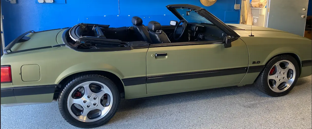

That looks awfully nice to me,
Reactions: Mstng93SSP
