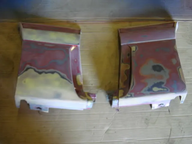

I'm getting close to paint and body. My car was repainted at some point and poorly done. Flaking paint, clear coated roof trim and stuff like that. I'm figuring on stripping the ground effects (GT car) but wondered if anyone ever tried soda blasting them? Have a guy close by that does it. Anyone??
Idk about soda blasting them....but I had some sand blasted once. Biggest mistake. They were so rough afterwards, 80 grit sandpaper on a DA was an improvement. I'm glad I didn't have all of them done.

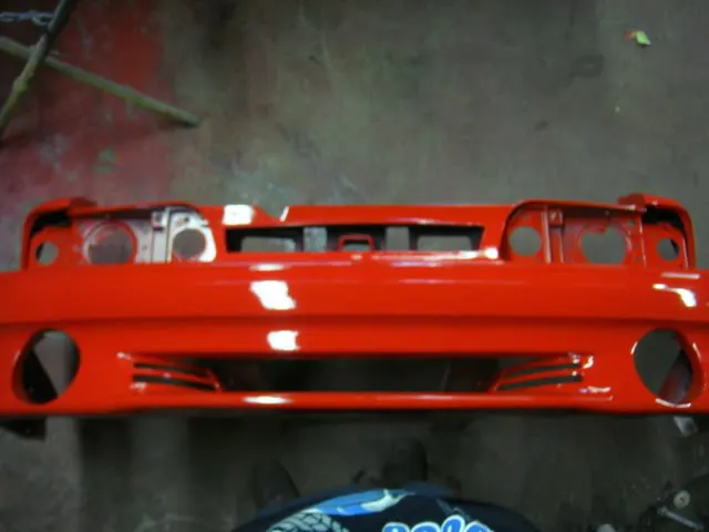

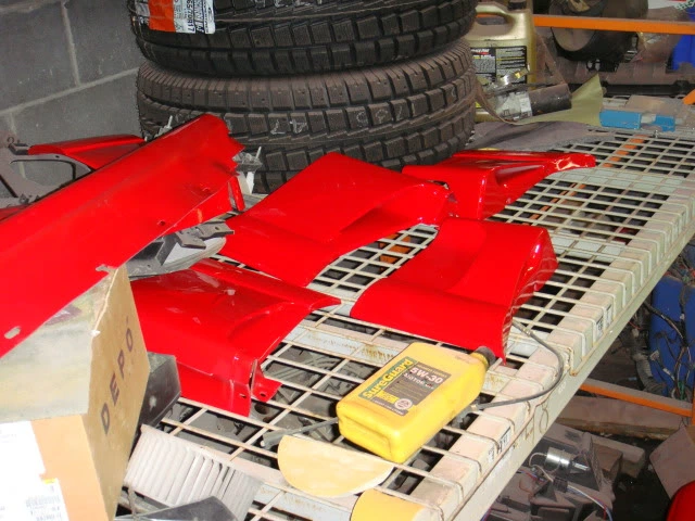

I 80'd the rest of them down, which works perfect. I follow up with 150, then I put them in 2k Urethane primer. Sanded them with 150 again...move to 320 and paint/clear them. Come out perfect every time.
Same with front cover
