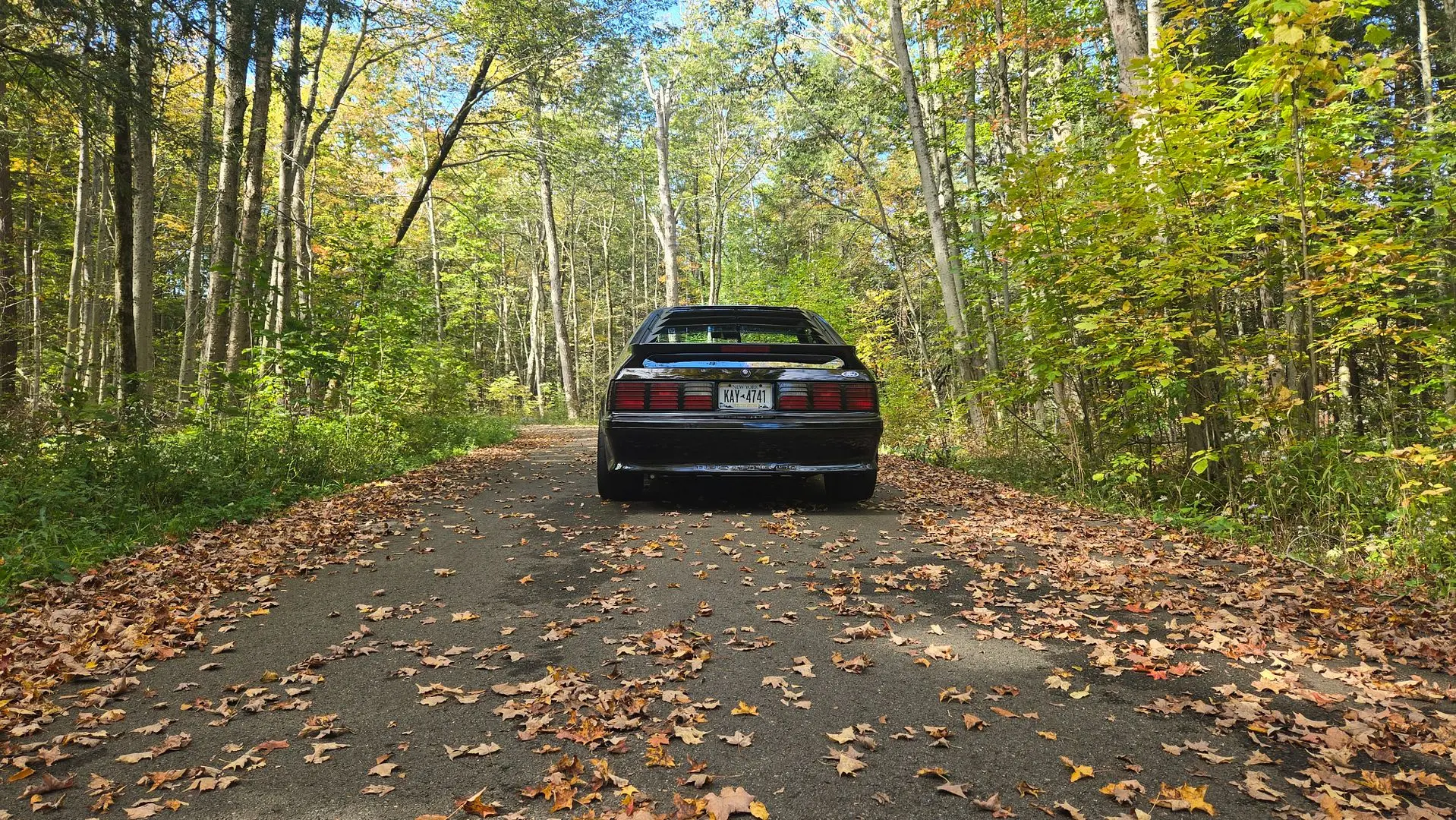

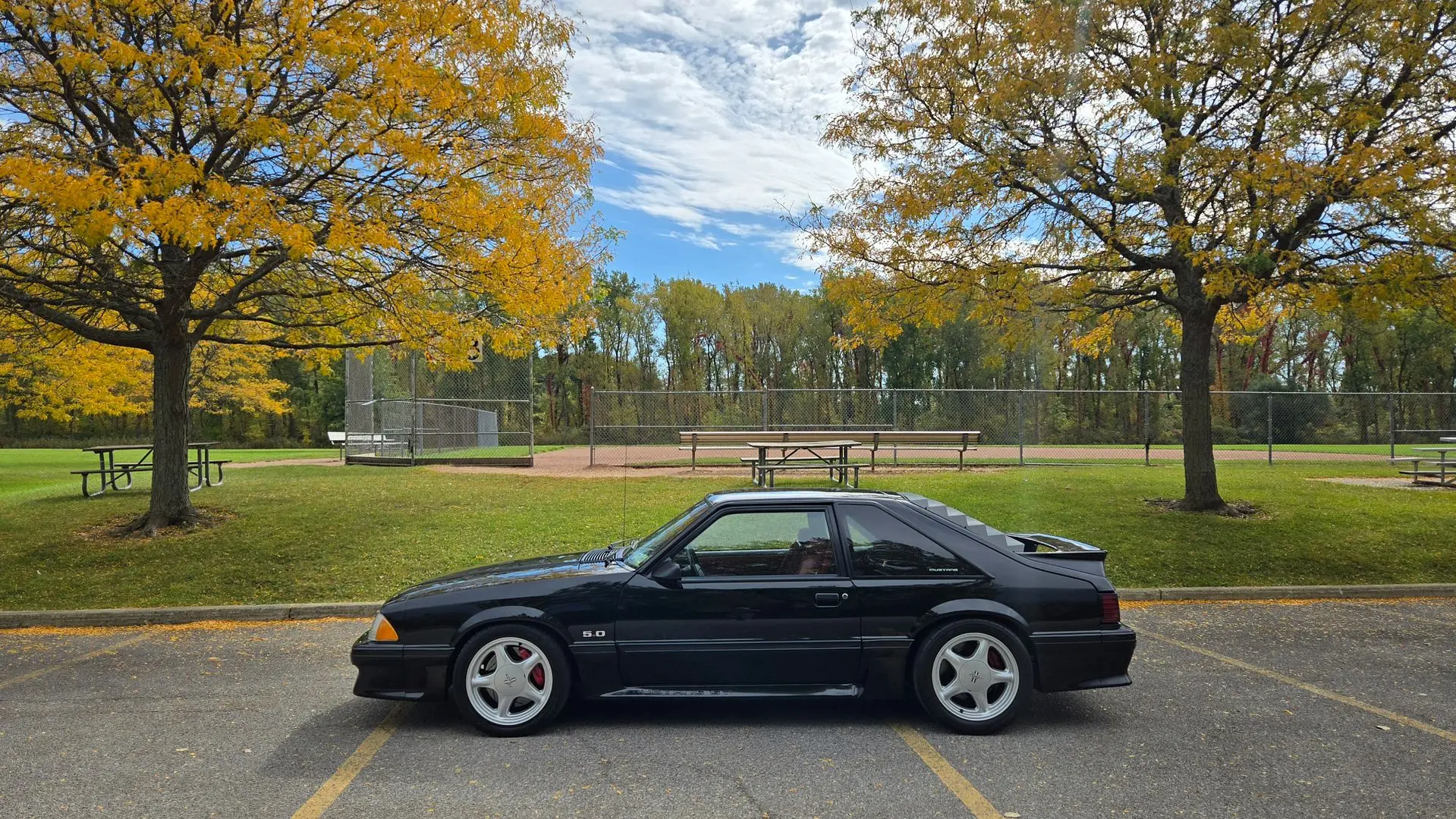

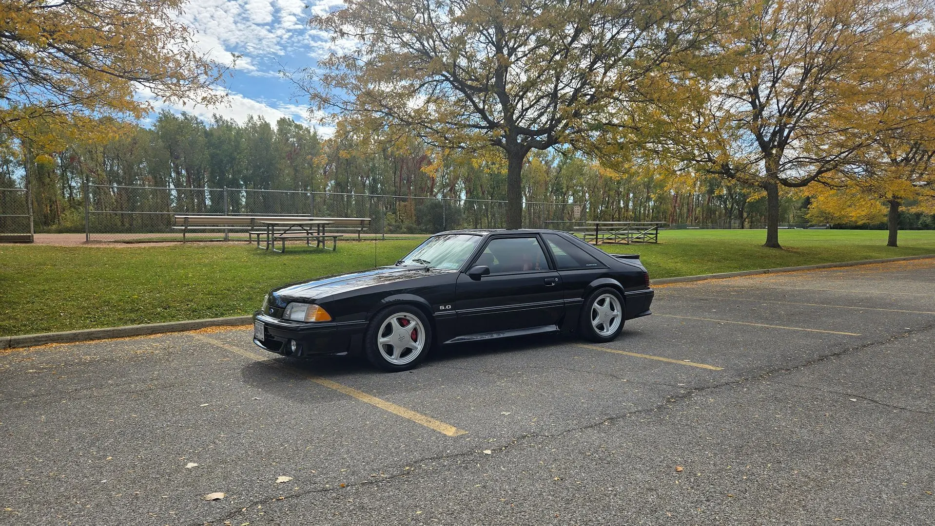

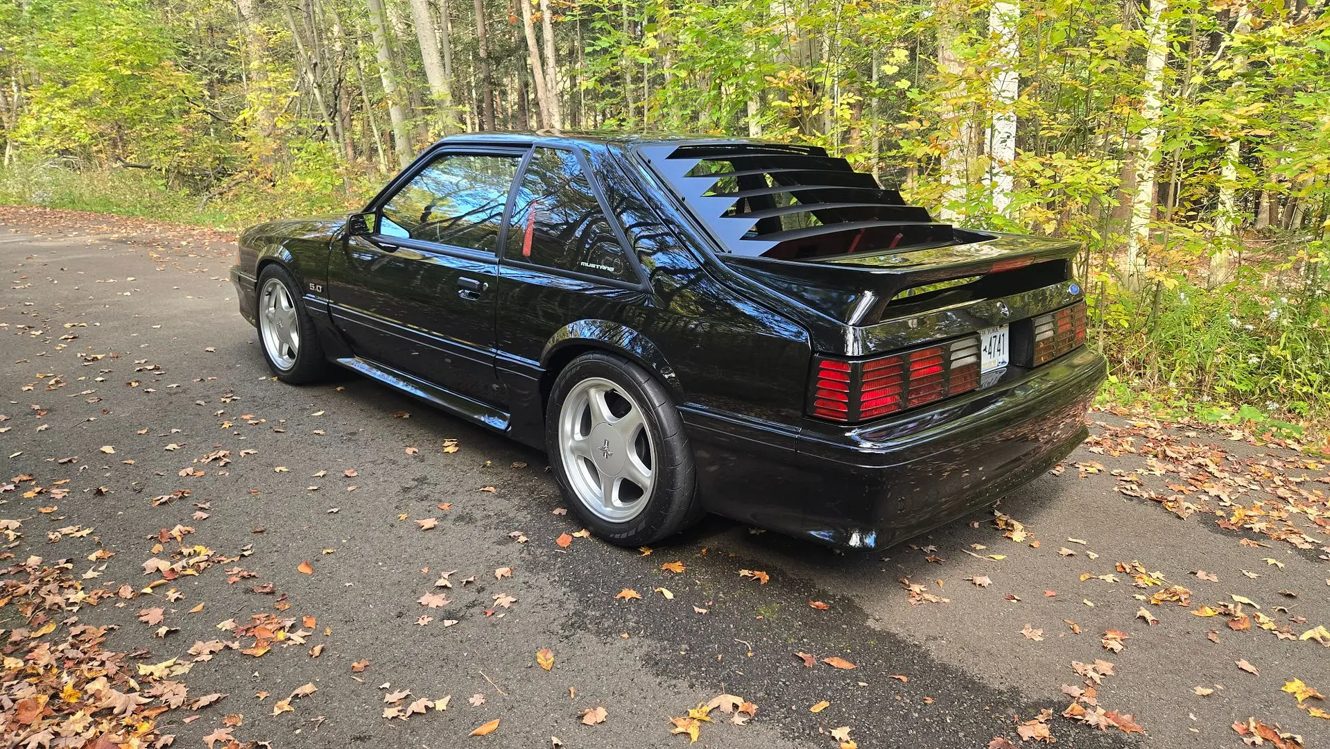

This morning I went out to get a picture hanger for the wife and took another country cruise. Gone for about 2 hours lol. This is my favorite time of the year. I love cruising through the back roads covered in leaves and seeing them all wash out of my way as I roll though and kicking up behind me in the rear view mirror. There's just something special about the fall.
I took a few pics this time.
