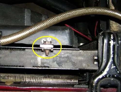

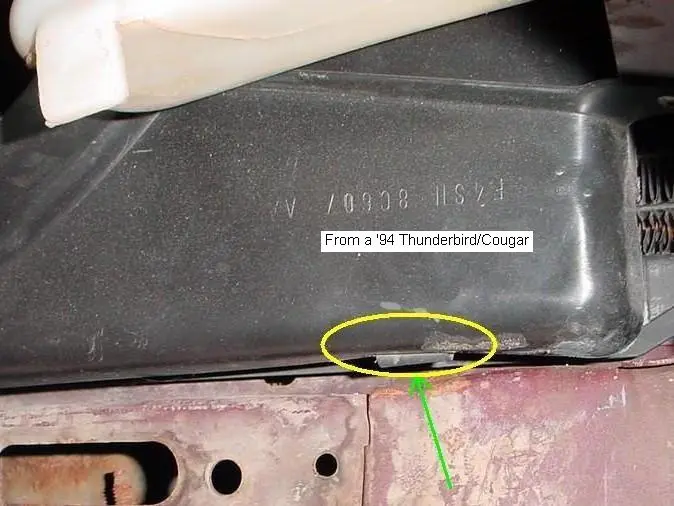

I just pop-riveted two "L" aluminum angles on the top of my shroud where the factory bolts go and drilled for the stock mounting bolts and then used a cutoff wheel to slot the bottom of the shroud to accept the stock mounting clips - the shroud was a perfect fit on my stock 2-core radiator.
