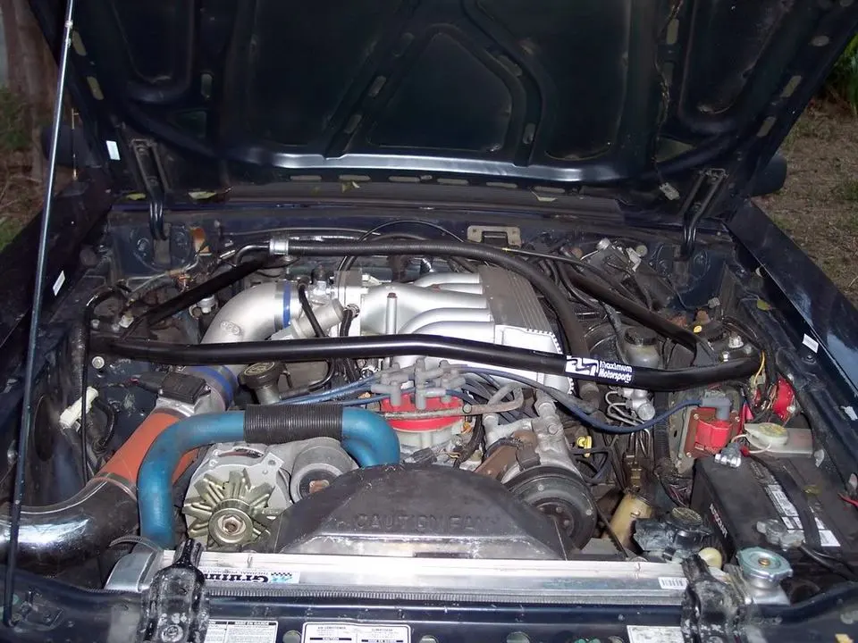

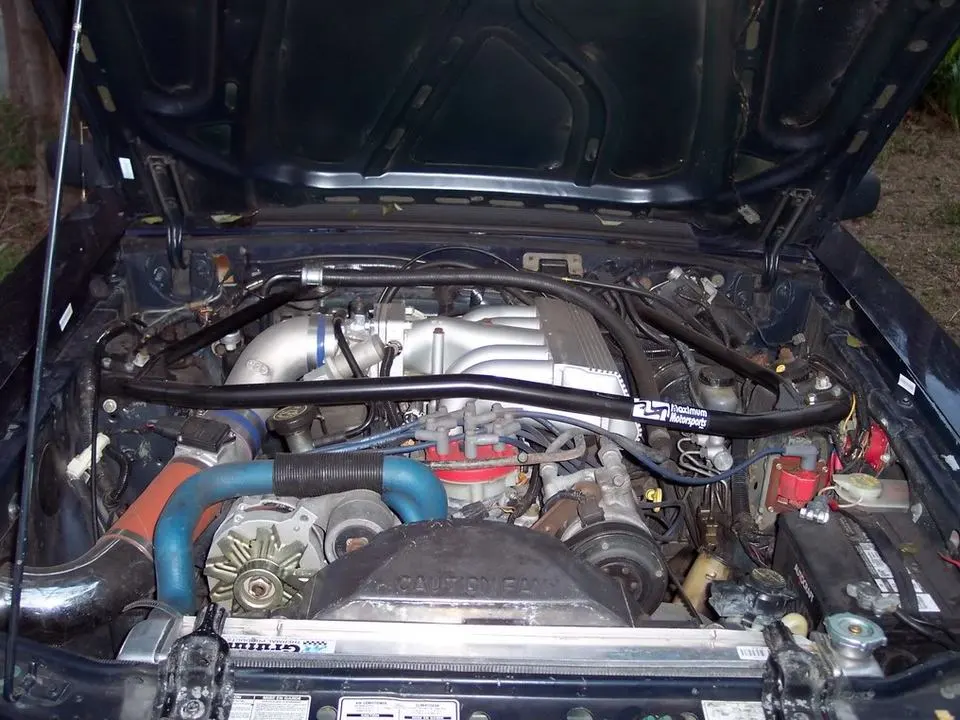

Love my MM strut tower brace. I have no issues with the oil filler cap on mine. I chose the MM because of how it mounts to the firewall, it bolts to the pinchweld which is a really strong point on the firewall. I would worry about the ones that bolt right to the firewall tearing the firewall around the bolt holes due to stress. That might just be me though
