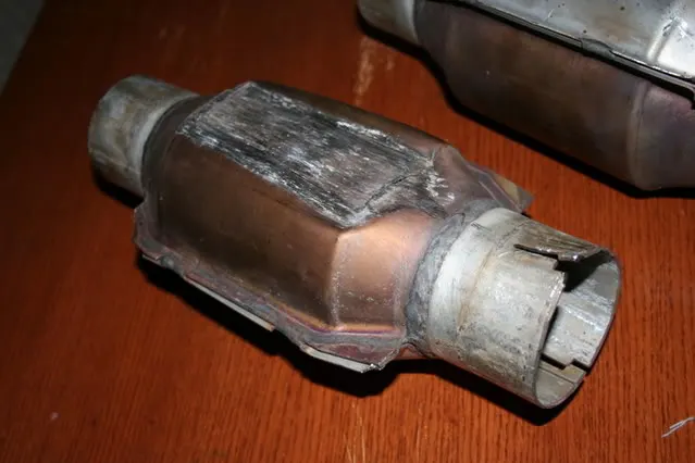

I scrape my exhaust on everything. thats part of the reason on dont have any more cats on my slp x pipe...destroyed them and bits and peices started coming out my exhaust pipes.
If you dont want to take the time to baby your car. do NOT lower more than 1.5"
i think the pic speaks for itself.
