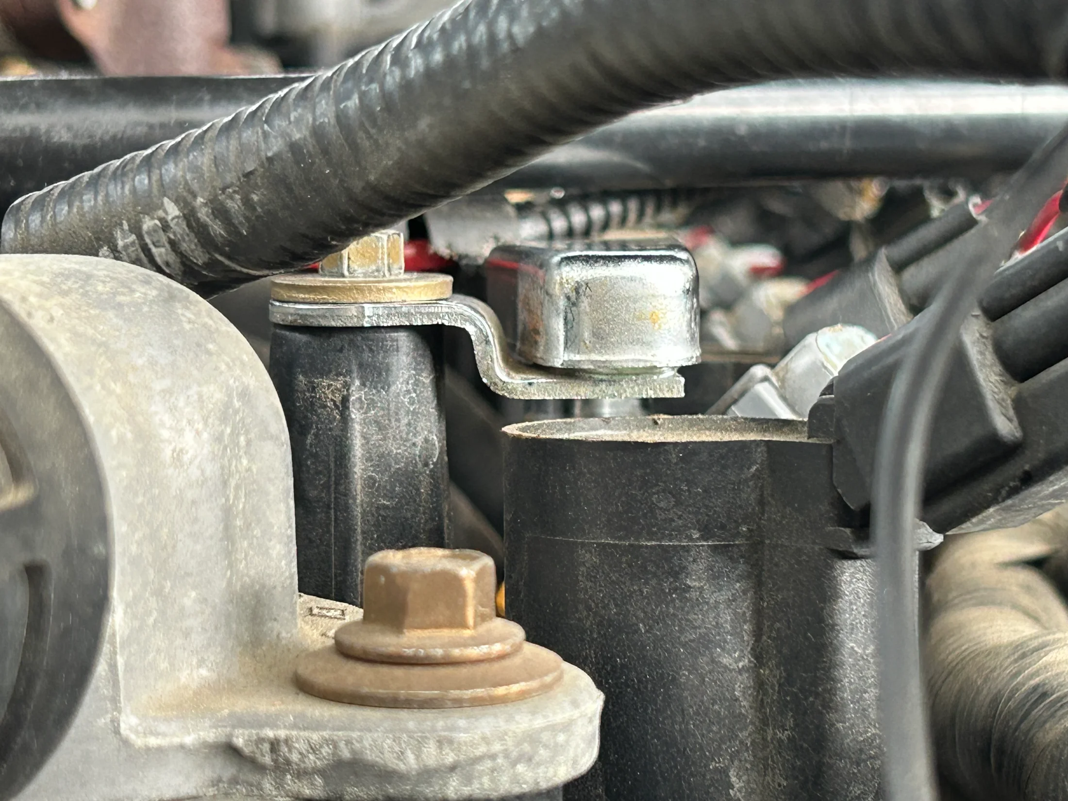

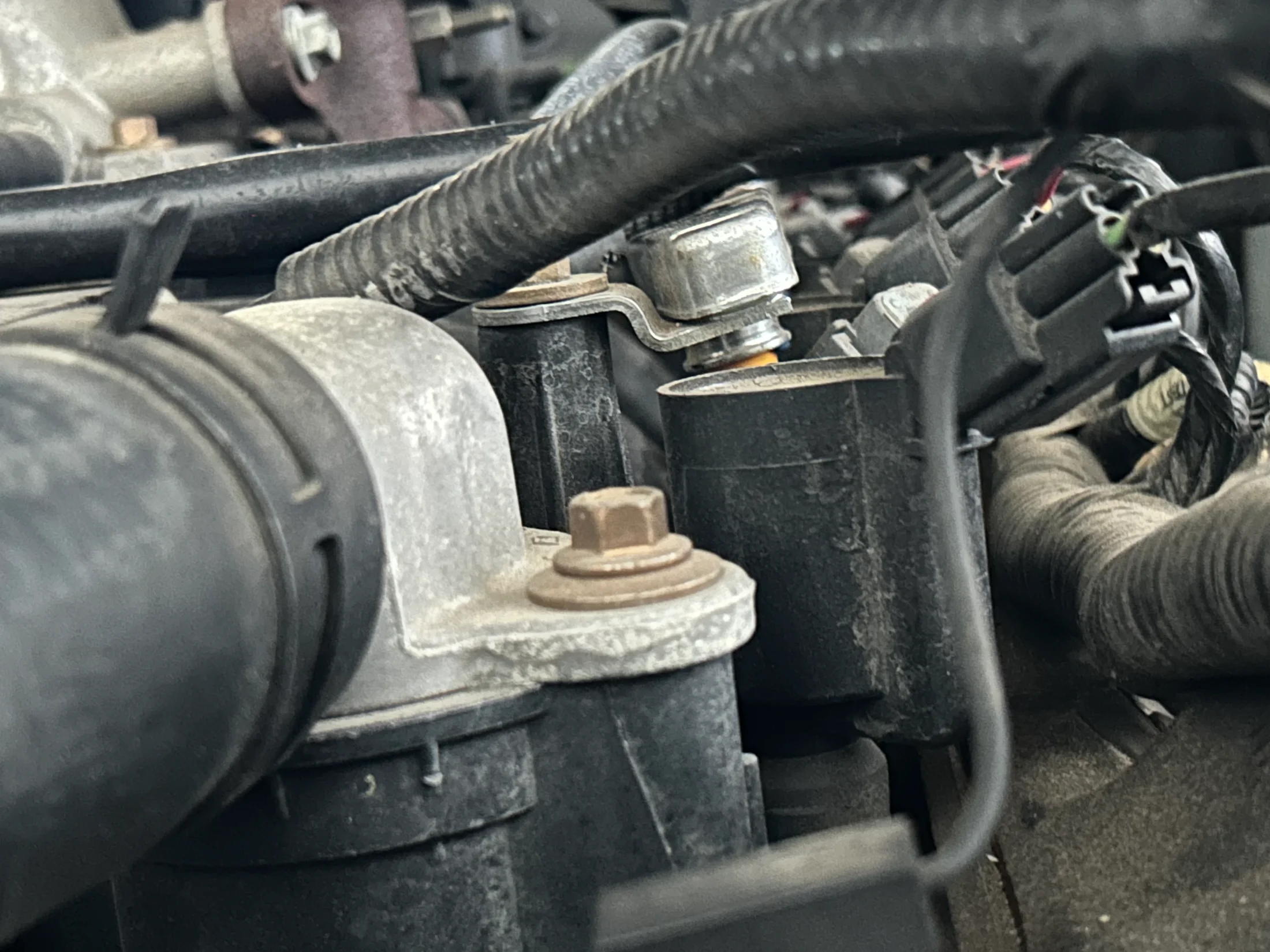

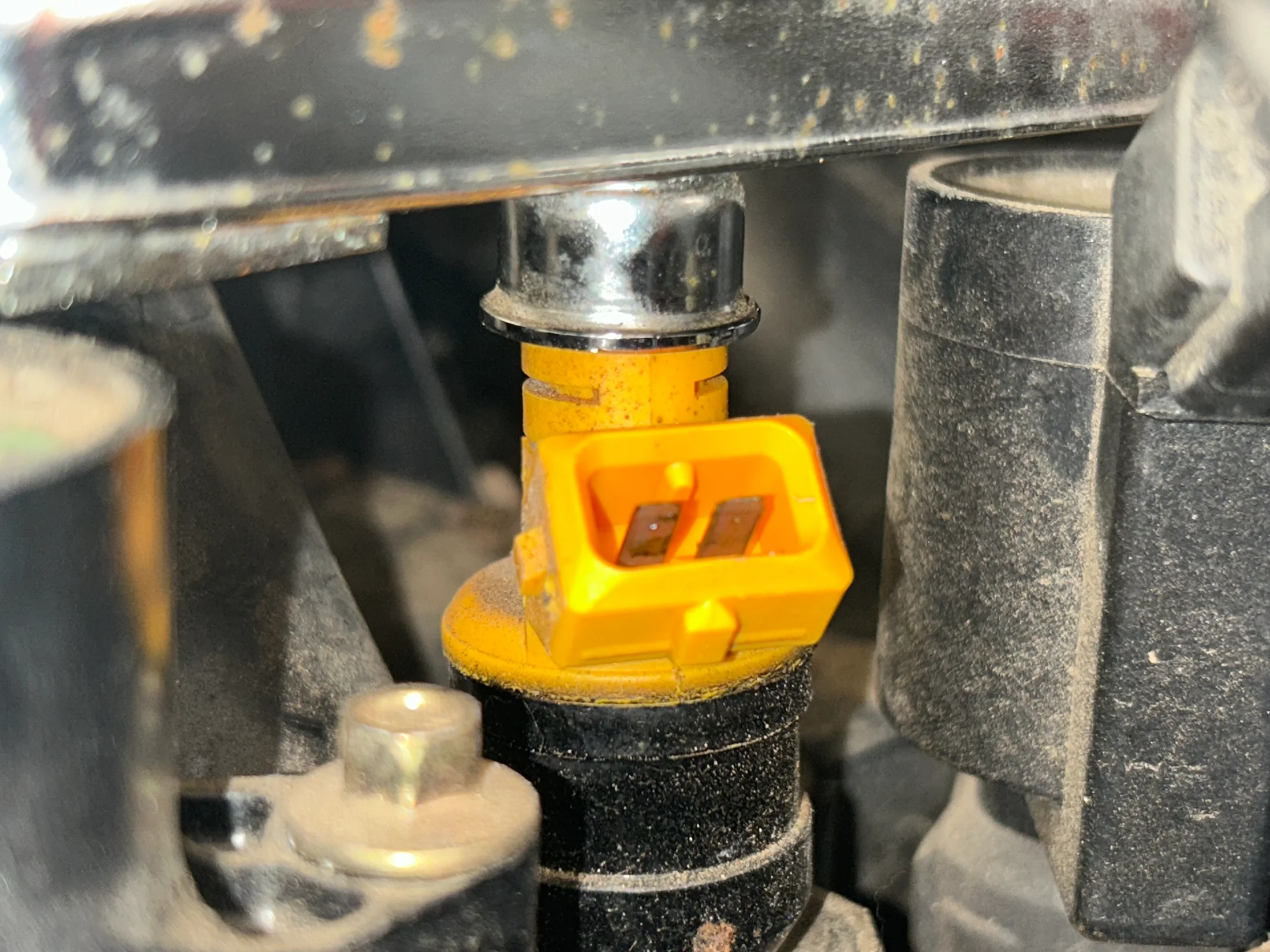

Hello, We bought a 2001 Mustang GT with only 14k miles this summer (all parts are original) ** This problem was also posted in old thread but thought I would make a new too.

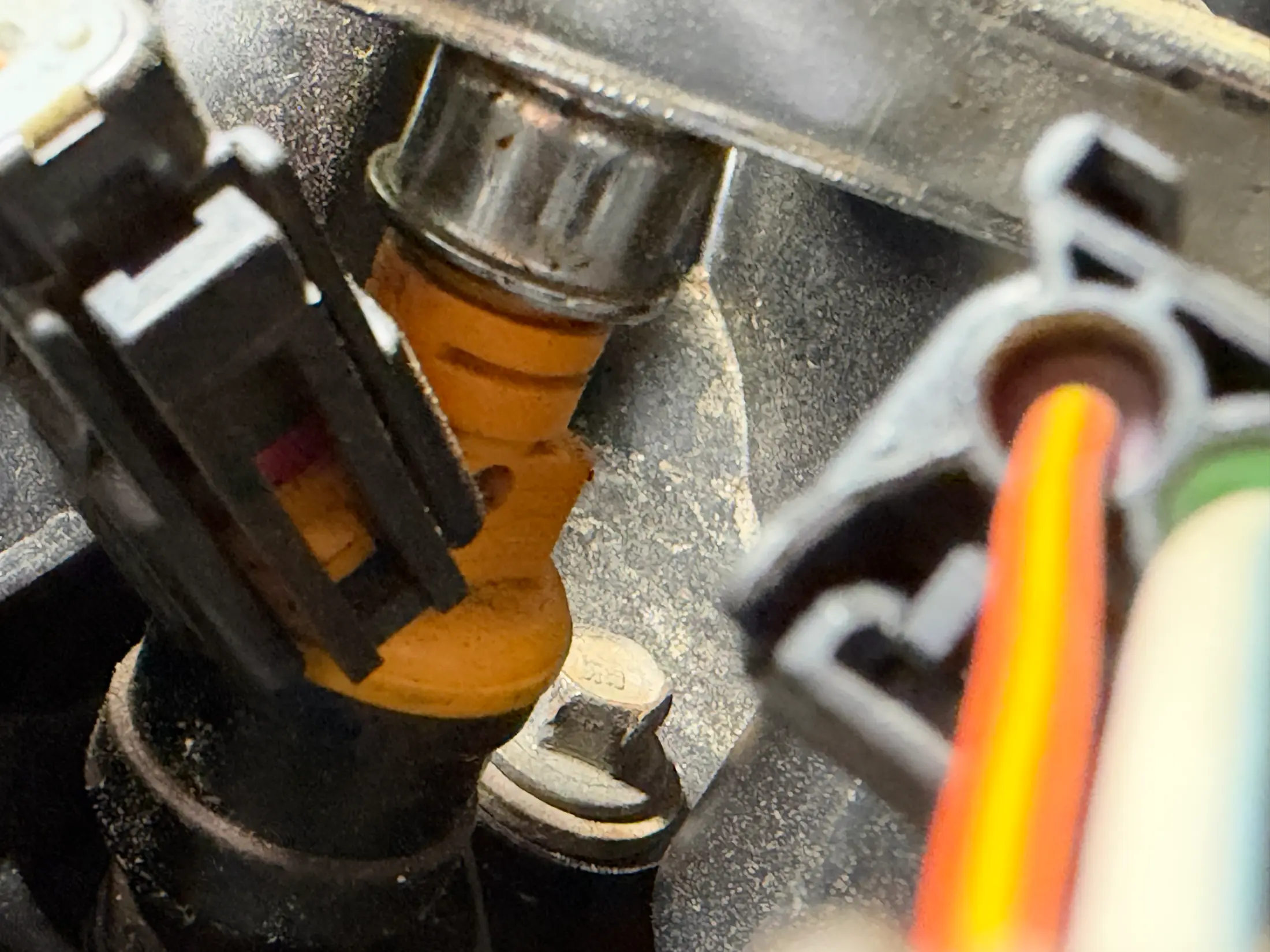

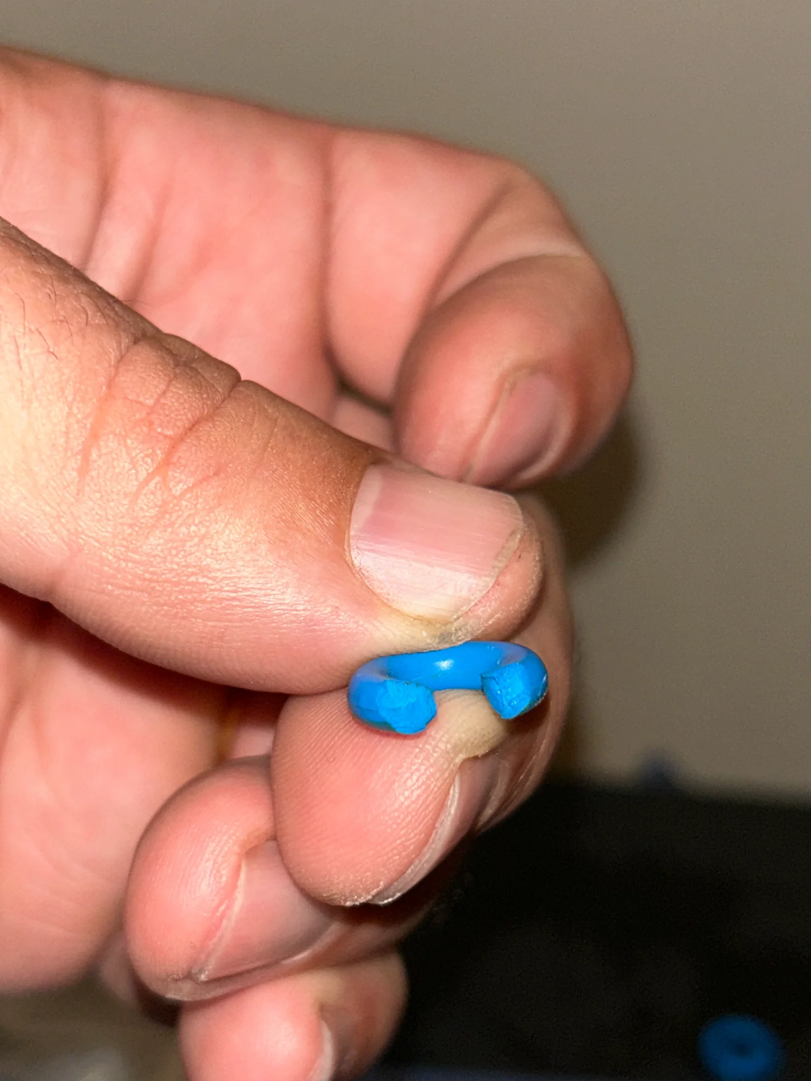

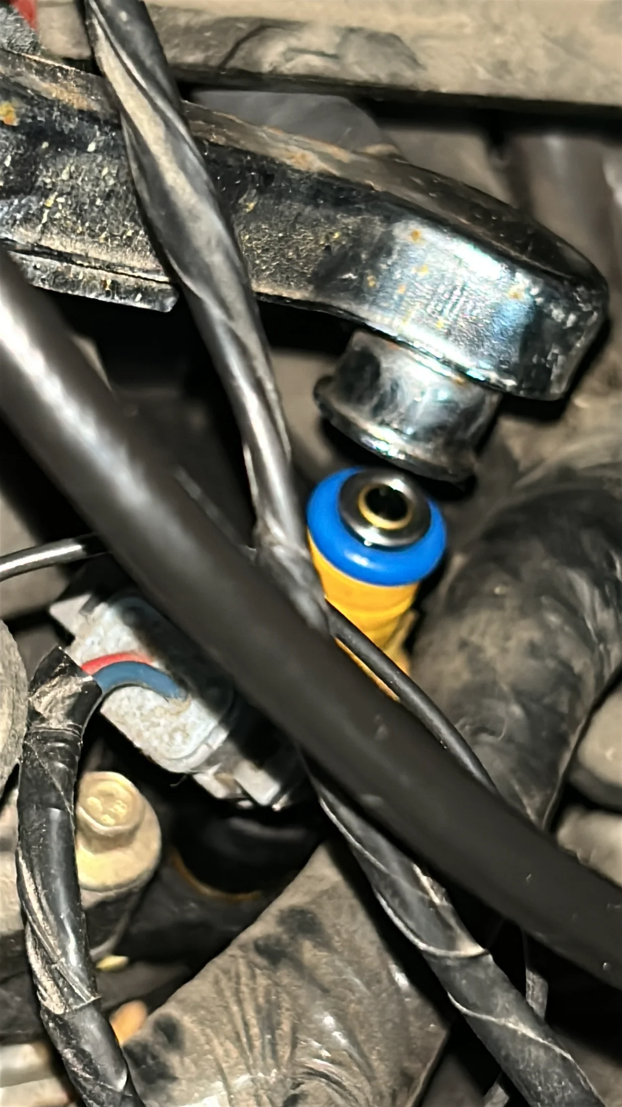

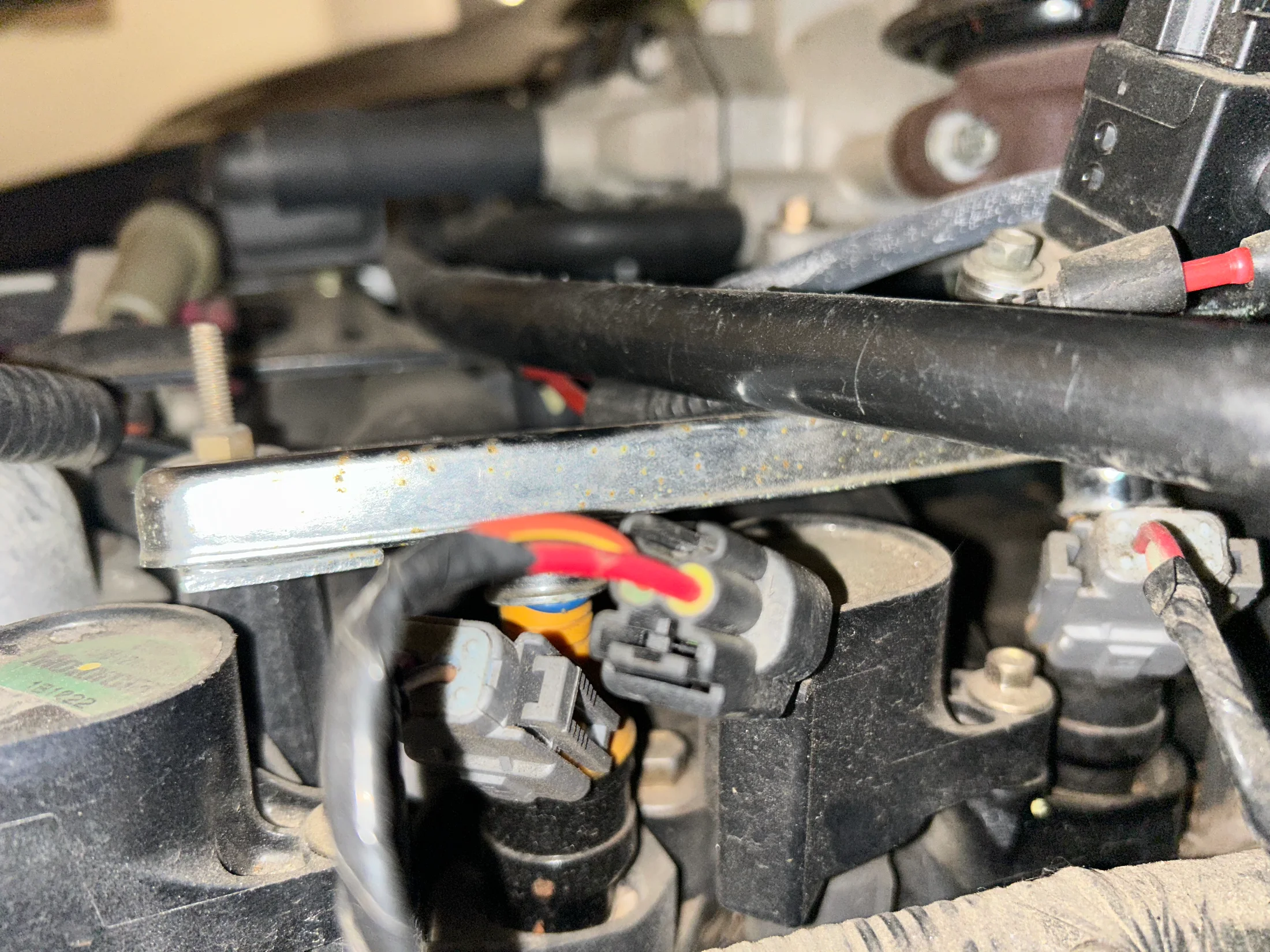

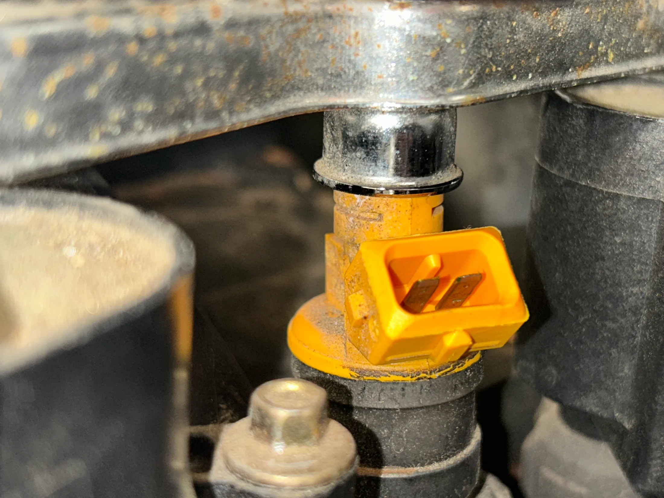

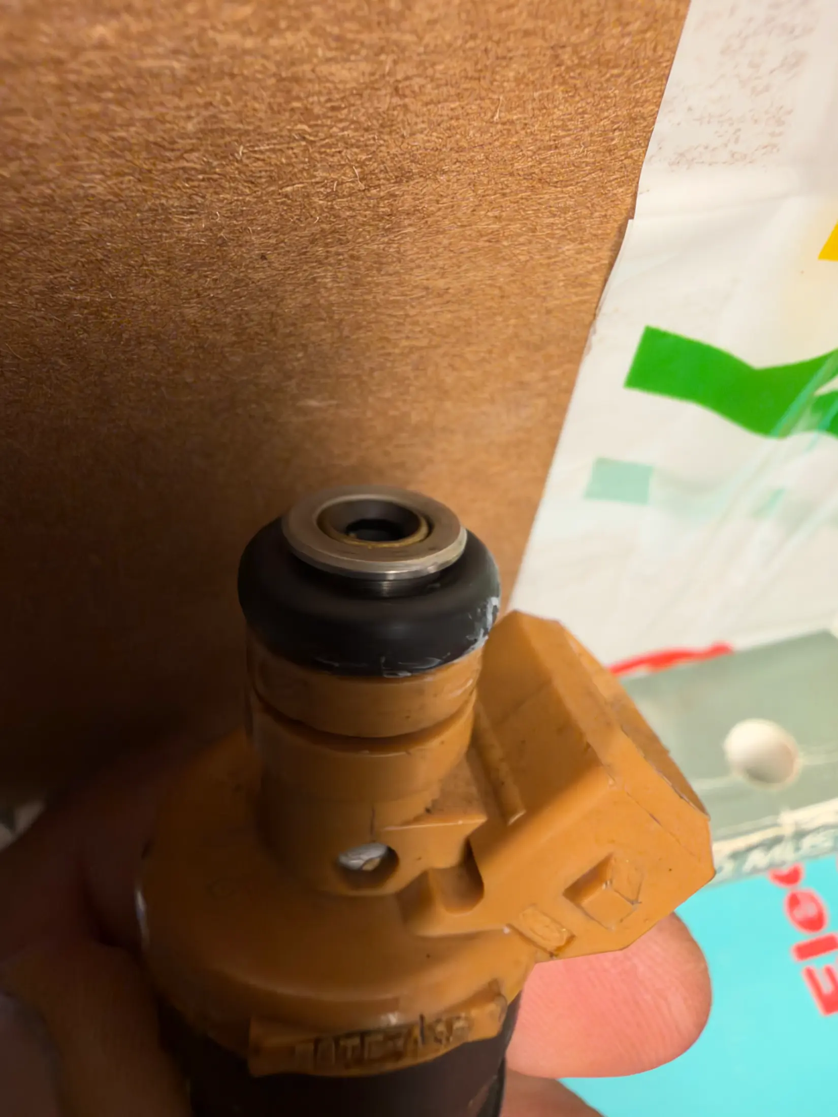

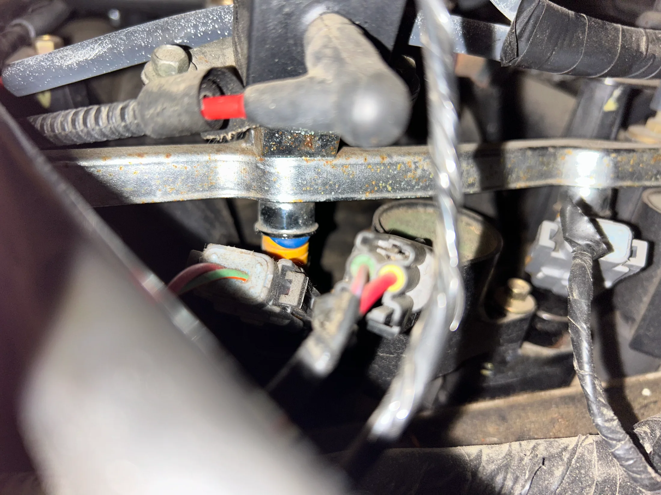

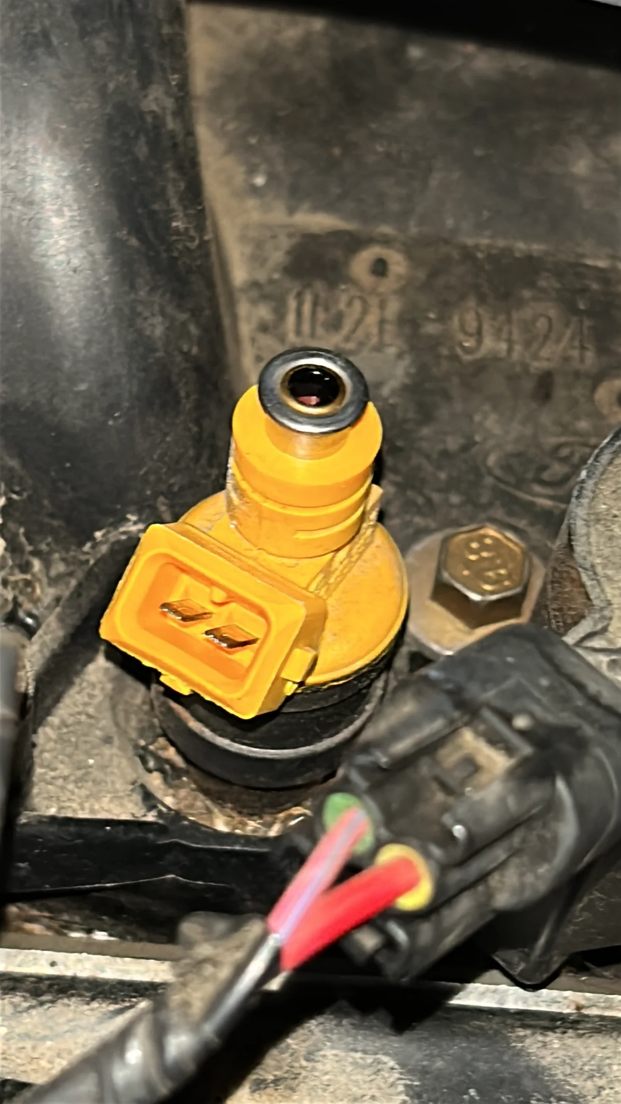

We have had the drivers side rail lift up 2x on us on cylinders 5 and 6. Did it about 1 month ago and I replaced top o-rings on injectors 5 and 6. I also bent the rail support piece back to 90 degrees. I chalked it up to previous owner. I may have pinched #6 o-ring when I put things back together last time b/c the other day it spit out part of the o-ring and lots of fuel. A little confused b/c it took a month before that happened.
I've ordered 8 injector clips and new top o-rings - the car never came with injector clips from what I've read, which is wild.
Anyone ran into that and successfully solved this - only happening on Cyl 5 and 6 with 6 being the most dramatic both times. Not wanting to change to aftermarket rails at this time.

Agree. Clips aren't necessary. The design of the fuel rail is such that pressure from the bolt-down hardware keeps the injectors in place.
Of the rail has bent upwards, it may be compromised now and you likely will need to replace it.
the rail is NLA from what I can see - i looked at it and it looks great except for the front support piece. I might weld another piece of metal there to beef it up.
what's odd is the injector is not lifting, just the rail - the 1st time I could see the blue o-rings from the side. this 2nd time it ripped the one in half.
as for a clogged injector - wouldn't that throw a code or cause some running issue? - car runs like new. I'll be working on it all on Saturday

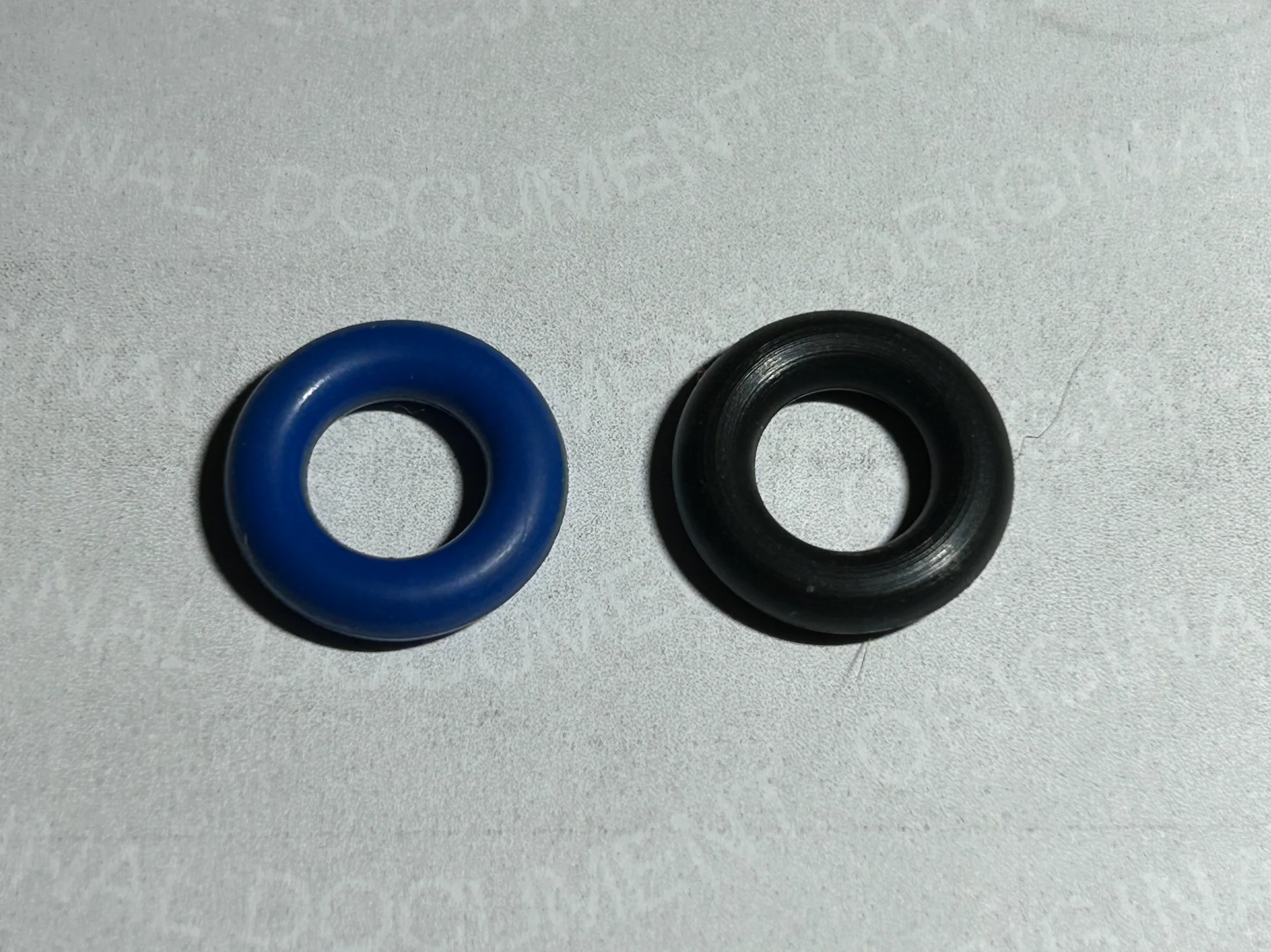

My first thought would be the injector isn't seating into the fuel rail properly. What o-rings are you using?

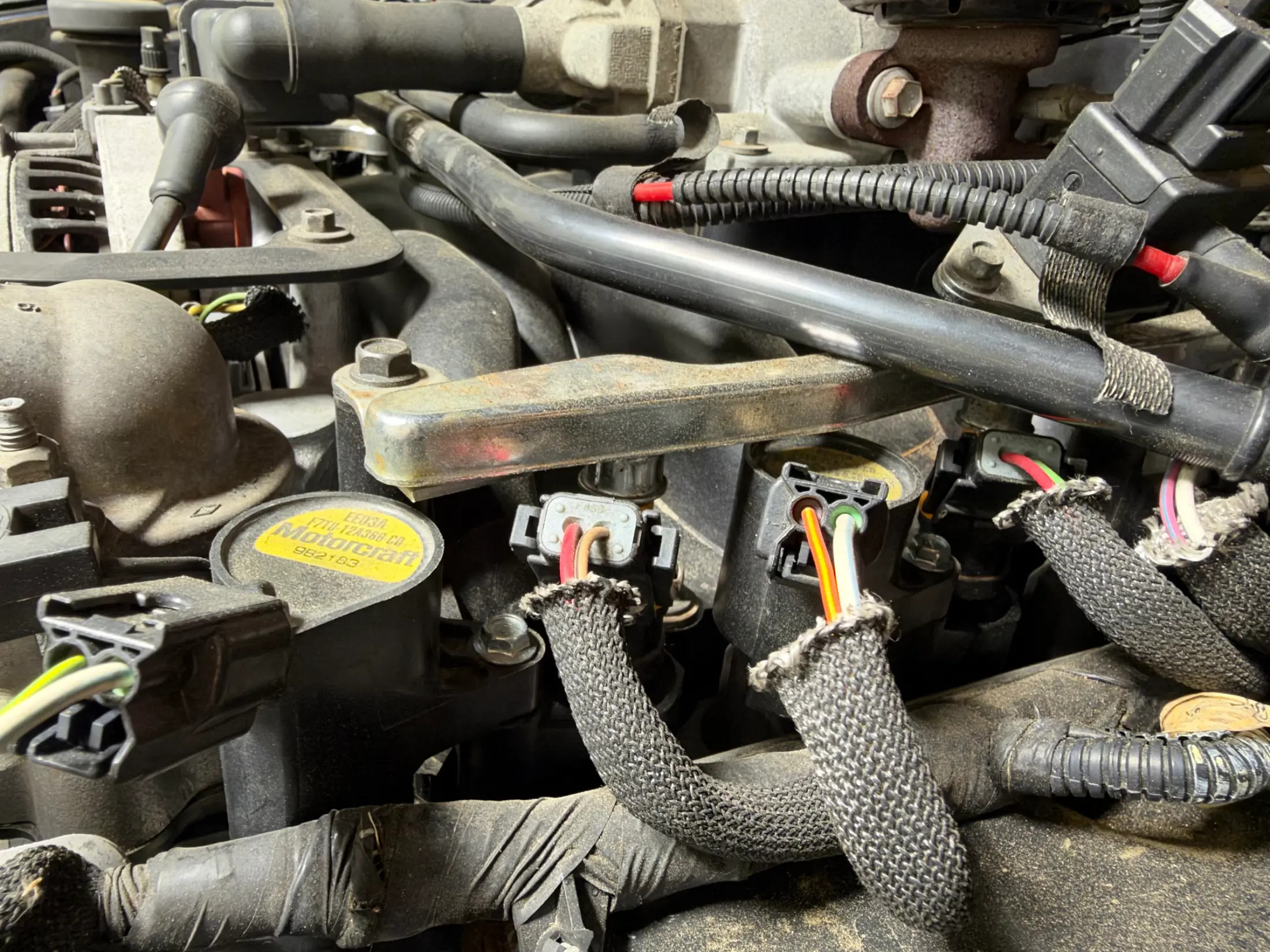

The rail is lifting by physically bending? Do you have an aftermarket intake (dorman replacement) or a factory PI intake.
Popped my hood to take a peek and there is one bolt at the front by injector 5 and the other near the rear. Grabbing between injector 5 and 6 and pulling up I get zero flex. Nothing at all.
Is the rail on yours bending? Is that front bolt in place?
