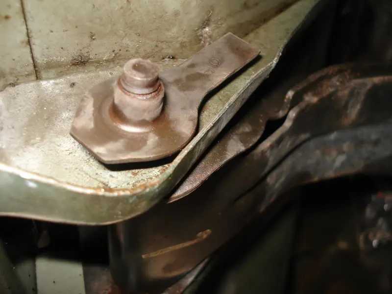

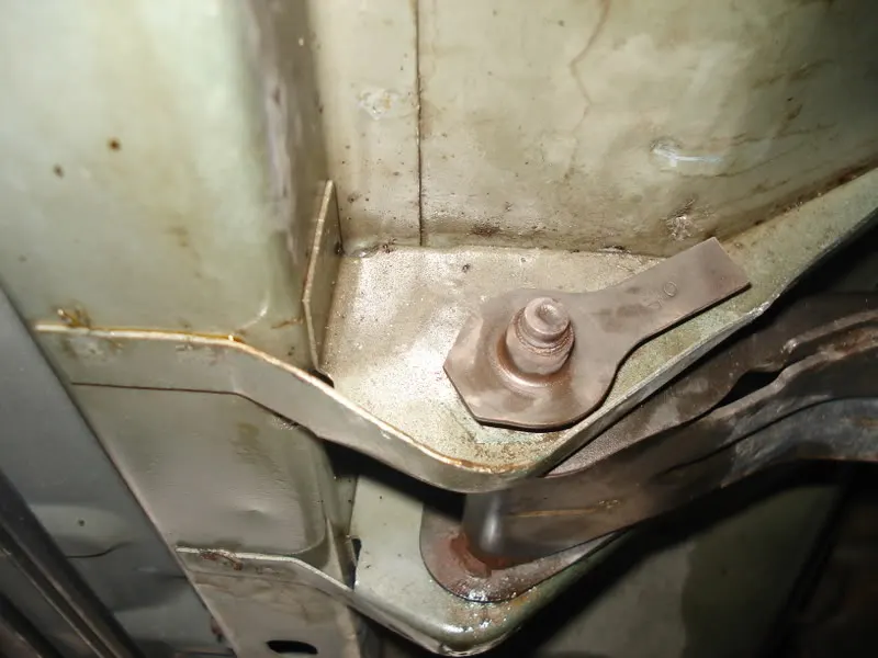

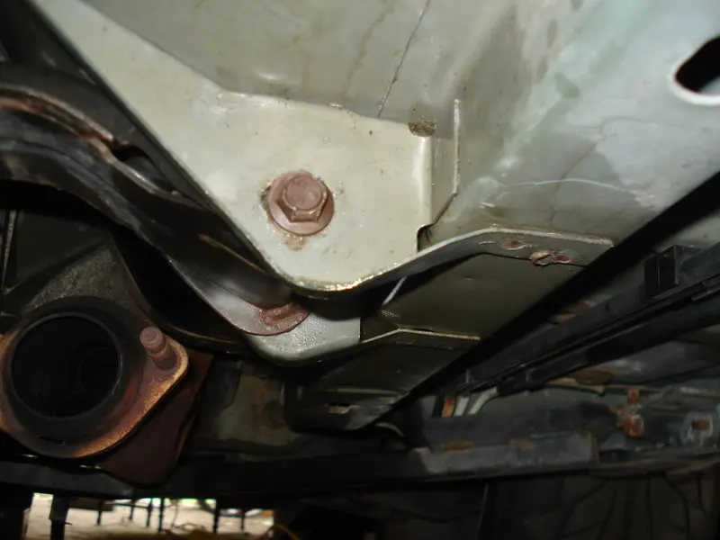

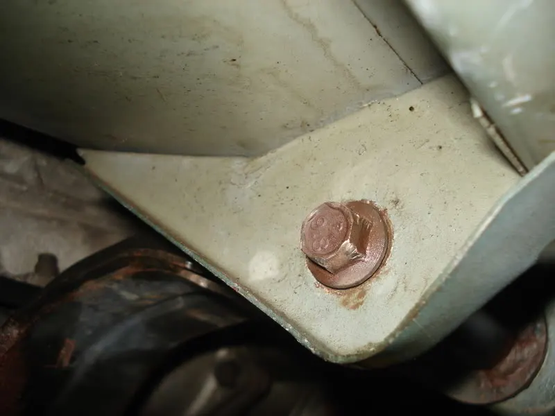

About to pull out and drop the transmission in my 94 GT. Everything has gone smoothly until now. Undid all of the bellhousing bolts as well as the bolts on the bottom of the transmission mount. All thats left is are the two on the side of the transmission crossmember. Now heres the problem, the bolts or whatever they are, are nothing like I've ever seen before. They aren't studs like the writeup that I have states. They look to be a bolt with some kind of weird clip at the end, hard to describe, but here are what they look like.
The "nut" is that way so you dont have to put a socket on it. Dont worry about that side. Just unbolt it from the bolt head just as you would any other bolt. Looks like your stripping that bolt head....Are you supporting the tranny in any way? I would get as much weight as you can off that crossmember before you try loosening the crossmember bolts.
I didn't really see aquestion in your post, but I hope I answered it.:D
Good advice above. Those are tantamount to having a nut and then putting a box end wrench on the nut and spinning it till it hits the underside.
It's also nice because unlike a tack welded nut, you have some maneuverability when reinstalling the bolt.
Good luck.
